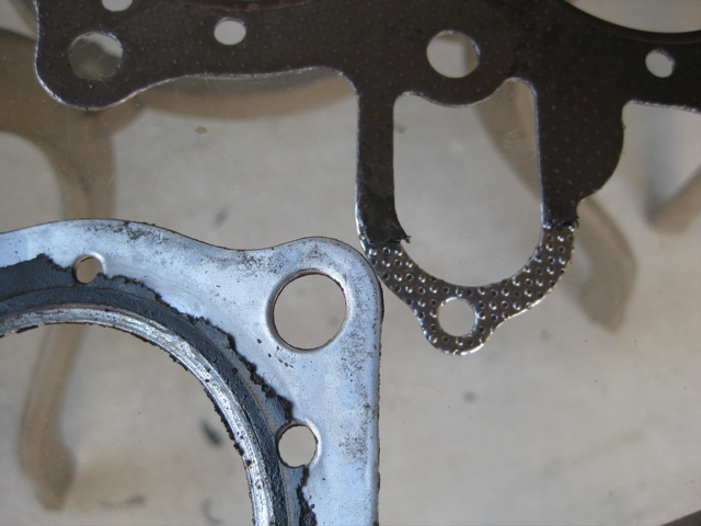

For those who appreciate the information, here's a side by side comparison of the OEM (on the right) and Saber's head gasket.
The OEM metal (with the dimples) is what I'm used to seeing in a head gasket.

dan filipi wrote: Best I can figure it blew by in the middle there
This is a Saber Cycle gasket.
From the picture Dan, it looks like a fairly serious roasting. Is the head pitted or burnt in that spot? If so you might need to skim it. Otherwise you should get away with a good cleaning.

thanks for the pics.. Sometimes it is hard to figure out what the differences are... but this shows CLEARLY that the gasket with tthe smooth surfaces is different than OEM... and furthermore, your experience is a testimony to the fact that it is inferior!! (but you don't need experience to figure this one out...) SDB/Jim

sandiegobrass wrote: thanks for the pics.. Sometimes it is hard to figure out what the differences are... but this shows CLEARLY that the gasket with tthe smooth surfaces is different than OEM... and furthermore, your experience is a testimony to the fact that it is inferior!! (but you don't need experience to figure this one out...) SDB/Jim
I thought that too originally until I realized that SOMETHING made the original Honda gasket blow out in the first place.
hmmmm....
But I prefer to stick to mama when the parts are difficult to replace or damned important.

I'm concerned about compression around the sealing surface. Sure looks  uneven to me. I believe those (cheap) hard gaskets need re torquing to insure full compression.
You might mic the ring in several places to verify.

Rudy, thanks for pointing out what was screaming at me here.
Dan, you're now putting at least the 3rd (stock, Saber, OEM) gasket on that bank...I'd be for checking what is warped or defective on the bike before sinking another gasket into that head...You've got a problem friend.

Could those gaskets have over sized holes causing some shift? Look at the intake port match/shift.

Rudy wrote: sandiegobrass wrote: thanks for the pics.. Sometimes it is hard to figure out what the differences are... but this shows CLEARLY that the gasket with tthe smooth surfaces is different than OEM... and furthermore, your experience is a testimony to the fact that it is inferior!! (but you don't need experience to figure this one out...) SDB/Jim
Yeah.. I was speculative... but my only experience was with 20+ year old OEM gaskets and the cause was not "blowing" but the splitting of the metal at the compression seal (probably corrosion)...

Well.. the first time with a new head gasket ( This SC gasket that is) was because I split the case and swapped the original '81 gears for '83 gears.
The head had to come off to do the work.
You have a good point Mike, if this was the 2nd blown head gasket then I'd suspect other problems, this was only the first.

Yeah, that's what I thought.  Siiiiiigh.
Honestly, I've never split a Wing case, never had a reason to...I'm sure I could do it, just not sure how much hair I'd have left over after the encounter.
Although it would give me a chance to get a good look at the rings
I dunno' man, lots to think about now.
Good eyes Mike.
It's 2 thousands all the way around.
Must be camera angle playing tricks.
