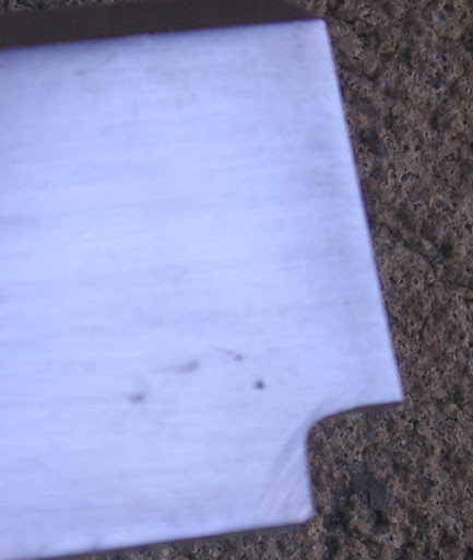

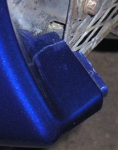

Shorten right timing belt cover per photo below. While precision is not required, the instructions will tell you that the cut must break into the hole to clear the newly installed pulley on the crankshaft. I ended up grinding the cut around the hole further back; it was just too close to the pulley-and belt- for comfort. I would recommend cutting out a full 2/3 of the hole initially; there’s plenty of overlap from the new cover. A hacksaw works fine. This picture shows where I made the original cut.

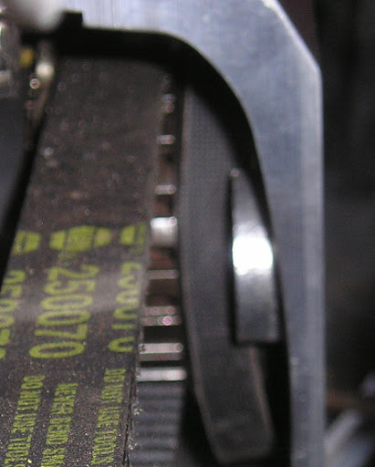

And here you see how close the right tb cover is to the alternator belt, even after I ground back my original cut:

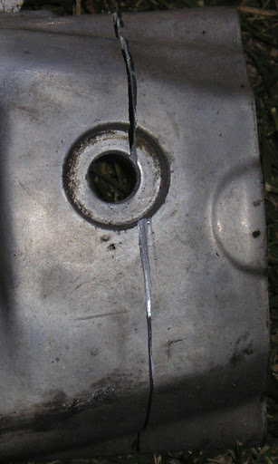

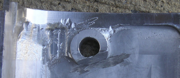

I also had to modify the new cover in 2 ways. First, I ground back the boss (I would call it a flange) on the inside of the center hole- it is also too close to the pulley and tended to catch the outer part of the belt when I tried to install it, even though it has a half-moon cut out already. Here you can see where that flange was pushing against the belt, and how I ground it back.
The other mod I had to do was cut a notch out to allow for the pickup coil wires clearance into the timing belt area. This is not needed on an 84 model because the wires are located at the rear of the engine. Trust me, though- if you crimp those wires during installation, the bike will definitely not run well! Donn had to grind a slight dip into an adaptor piece to allow clearance for a water outlet on his 84.  Here's the notch:

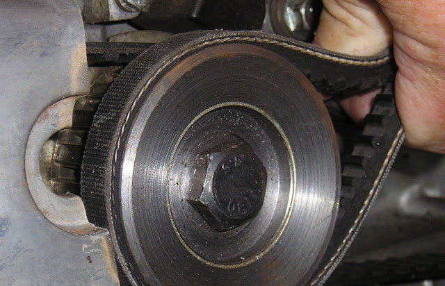

When it comes time to install the new cover, it is necessary to remove all nuts that hold on the left side crash bar. The new timing belt cover is simply too long to install otherwise. You don’t have to remove the crash bar, just let it pivot downward out of the way.
Important! As you begin to position the cover into place, do not secure it! If you do the crash bar will not clear the cover and you won’t be able to get it back in place. Get the cover close to position and swing the crash bar back up over it; then you can secure the cover.
When installing the alternator onto the tb cover, I fashioned a “hook” out of a short length (4 or 5 inches) of metal clothes hanger to assist in getting the belt onto the alternator pulley. (The belt itself is inside the tb cover.)
