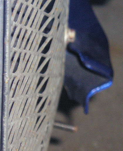

The radiator extension bolts are necessary for the radiator to clear the cover, but it makes replacing the lower radiator hose not a lot of fun. The NAPA part number for the hose is 8101- you have to cut some off of each end- and for me it was a chore. Donn had no trouble, though. I also found that the extension bolts threw the bottom of the radiator out far enough to prevent the attachment of the lower piece that attaches to both lower fairings. For me, that was not a big deal- it may be to you. I believe that piece could be attached with some trimming. The next two photos show what I mean:

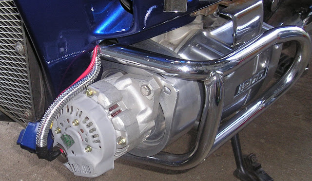

All in all, this was a difficult install for me. I put on and took off the new timing belt cover half a dozen times. Knowing the necessary modifications would have helped immensely. You should just be able to hold the cover in place once to verify whether these mods are needed for your bike. Good luck- and I'll be happy to help in any way I can. Here is the end result:

thanks for the info, but when my alternator fails ill go for poorboys kit as i dont believe that two 6mm bolts will hold the alternator and cover for a long time.

I will surely keep everyone informed as to how it performs. You bring up an interesting point though, William. I wonder if I should run a small brace from the top bolt of the alternator to the frame. Hmmm...

Don't think I want my alternator sticking out front where it can be struck.

I installed the Dupli-Tech system on my 1984 Interstate last year and had no problems with it. The new left side cover is machined out of a solid piece of billet aluminum and is much more solid than the original piece. Nothing has loosened up since installation. I removed the kit to remove my engine last month.
