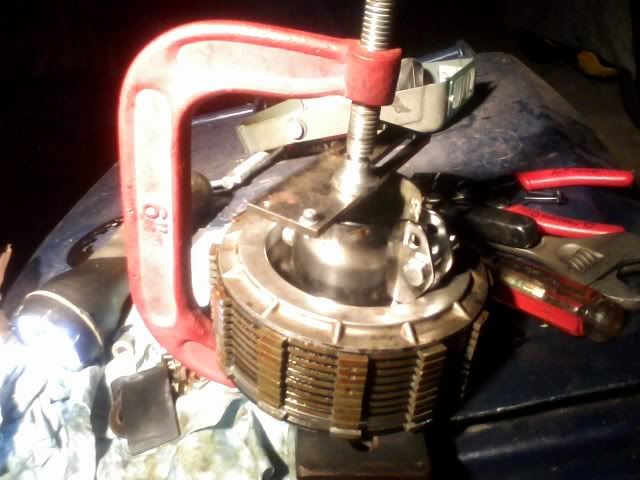

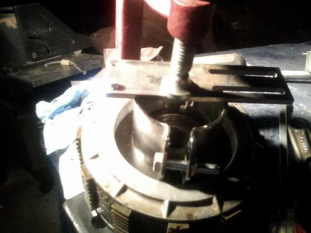

Well finally have my clutch back in. I did make some clutch pack tools. Used some Large pvc fittings and modified them for both alignment and installing the
spring circlip. I did take a few pics of the assmebly and the clutch pack and will try to u/l them later. Pain the the butt for sure. But should be on the road today after I clean up and do a few test. So if someone would like to see my tools then pm me and we can figure it out. Not one to just do the picture thing but having to make a could of tools took some thinking. Much better than buying the tool from honda for sure.

- once you get the clutch pack in hand, now it is fun time. The little cup that secures the C-clip is delicate, do not try to push down on it. I finally used a clamp from an old VTX windshield... it could be opened up to the right diameter to just be outside of the 'cup' while it offered an opening to eyeball what I was doing on the C-clip. This is similar to a fork seal driver (search for this on ebay)PM me I have photos. I then used a 6in C-clamp with a metal bar across the top of the windshield clamp and a metal plate on the opposite side of the clutch pack. Spring will move easily, but if your fixture is too close to the cup, you may have to push it down a bit to get the space to remove the C-clip. Big hint here; use a good set of C-clip removers... junk ones will just drive you crazy.
