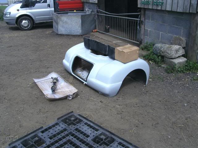

HEY any of you guys reconise this body?
it's here and in one piece, and its not that far out , should not be to hard of a job,

well its all coming together,and on the trike already

Hey that body does look like something I've seen before.
That's great it fit first time.
Looks like you may be able to glass in the extra trunk part also.

Body really transforms the look,your well on your way now

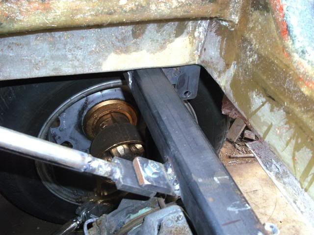

Barry , the body looks sweet sitting there . Did you solve the rear shock issue ? The newest photo seems to show the upper mount has changed .

im waiting for another stock spring,from a 1500 off ebay, im going to go with one either side, as there quite strong and if i need more because of the weight of the body and top box ,then i can add an air shock to each side too,
the top mounts have changed , there longer , as i move the axel backwards last night ,to sit in the centre of the body,im not to happy with them as there just temp, plan on makeing a stronger top mount and also fix the front of the diff and fix to the bottom ,
now i need to re-cut the axels again this body is 57" wide, there was a mix up somewhere , as i thought the skips body was 60" wide, so my axel is set at 59"wide,
but hey ,it keeps me busy,

IF your axle is wide could you not find a wheel with more offset instead of cutting all your axle parts a second time ? Perhaps a set of fender flares would be good solution as well . Maybe Skip could fab some up at less cost then the cutting . just some rambling thoughts
