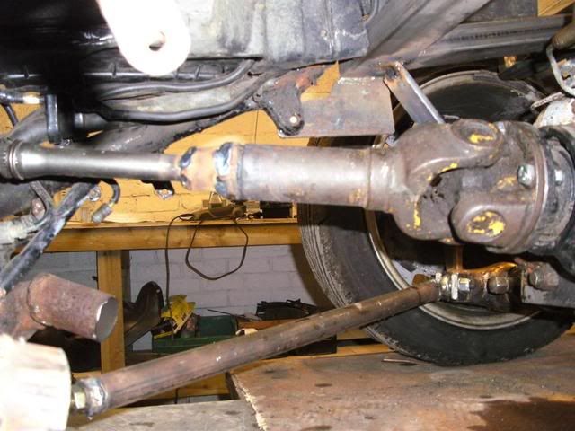

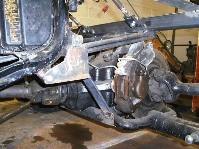

had it out for a test drive today , runs fine , it was loud though, only problem was them old brake disc s were binding on so i cleaned them up and freed off the two calipers , it seems alot better,
heres a picture of the propshaft and also i welded in some extra suport onto the bottom of the diff

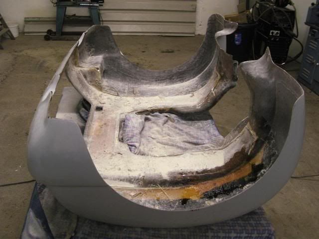

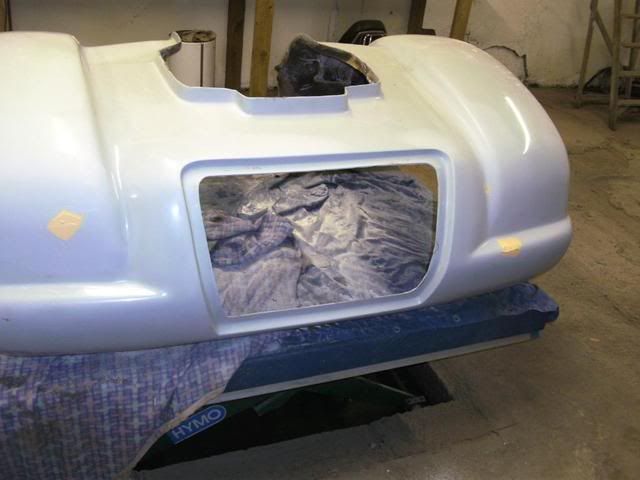

had my first ever atempt at fibreglassing today and it's not easy , when i got this body off skip , he had cut this part out ,to clear his chassis, but i have a little bit more clearance , so i altered it and glassed it back in, also skips shocks stood proud of his body ,so he made two square resesses , i have cut these out as i don't need them and when i make a mould ,it will be easer to get apart with out these in the body
this is a piece i trimed off , but it fits nice in the gap, so i started to glass it in place

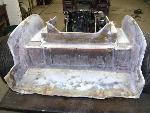

heres a picture of the sub frame which carries the trunk
i have started on the body
,notice the new glassing, im just learning

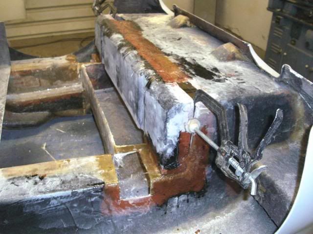

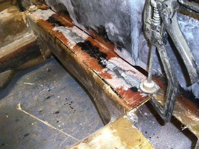

started the body work skip, ,
i messed up ,!!!!!!!!!!! when i was cutting the trunk out, i cut through the outer body, had to glass it again and fill it
