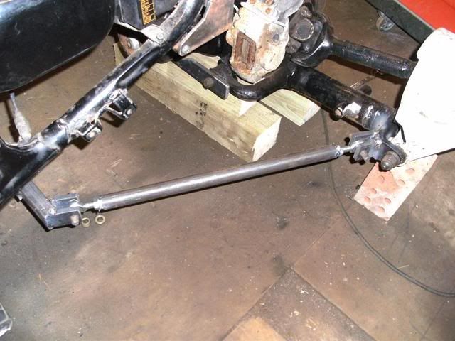

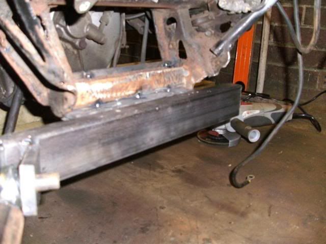

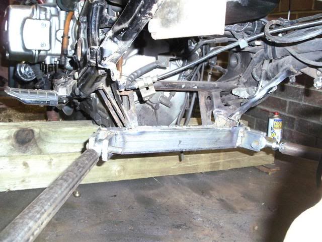

got some cds tube , and the weld inserts fitted tight, got it all tacked in place , as i may need to alter it, when the body comes, i have set it at 24" 3/8 from the center stand to the center of the drive shafts, , i have used the squareframe section behind the stand as a fixing point , but i intend to re-enforce this , with braces, when im sure it's all set up right
in this one the diff needs lifting up , as you can see two bricks are usedto lift the hubs somewhere near

Hey, the pictures look great!.
You sure that Sq. tubing not to low.
Trailing arms look good.
I see you got the lower support bars on now.

hope it s not to low , its only tacked , so i could always move it up

i cut the bracket back off tonight and moved it up 2" , was not much work , but i think you were right as it looks better

that idea of yours worked fine , fixed that problem , i have lifted the top bar up with another peice of box section , plan to weld it up and re-enforce it when i take it back off , and the distance between top shock bar and bottom wishbone is around 13" or 13"1/2 ideal for the 416 progressive shocks that i ordered yesterday from america , guess that will take around 2-3 weeks to get here ,
this picture shows how i have lifted the bottom support bracket up 2" , i still plan on braceing it more for strenth
