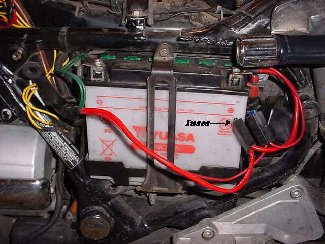

How can you tell if the wiring trick has been done to your wing? I had a guy pull off my sidecover once, and told me it had been done to mine. And what does this really do to the bike?

Pull off the left sidecover where the battery is. To the forward side of the battery, there will be 3 yellow wires. Now, if it is still factory, the 3 yellow wires will run through a small whitish 3 pin connector. This connector will be right forward of the battery. If it has been modified, the connector will either be gone or the wires will have been cut from it and soldered together.
Here is a picture of a bike that has had the "harness" installed. See the 3 yellow wires? They have been cut out of the plug, soldered together and wrapped with heat shrink.

Just went to the garage and snapped this:
So I guess mine has had this done?
It appears so. Did you pull the wires out to see that they were soldered and shrink wrapped? If it were mine, I would want to check it over to make sure that the job wasn't botched up.
Your "plug is definitly history butI'm curious as to what is tied to the red/black that is hardwired direct to your battery with no fuse in sight????
Looks to me like it might be a quick connect for a battery tender.
Or a plug to plug ina pancake cooker :goofygrin:
Hardwire for his deer alerts...

The red and black on top of the battery is for my hot chocolate maker:goofygrin:
