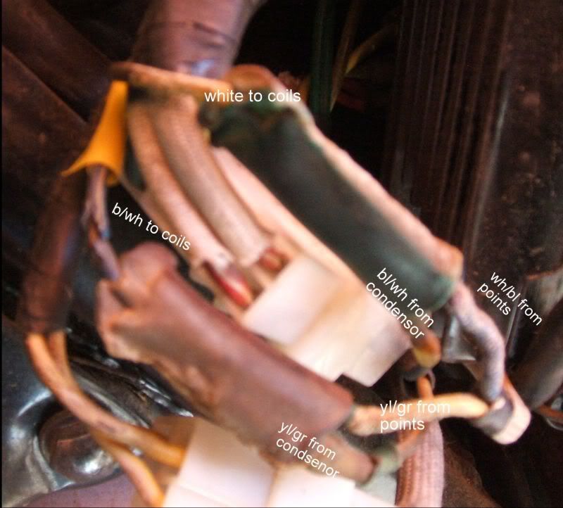

I think he meant with the kill switch in the ON (RUN) position. Anyway I think you said you had good spark. Is the gas getting to the cylinder? If so, try swapping the primary leads on the coils. If they have gotten switched in the rebuild process, your spark will be 180 degrees out of time. The Y and B/Y wires.
It's got to be fuel, air, or spark. My guess is spark. If it's coughing through the carbs your coils are hooked up wrong. I speak from experience on this one!
I have nothing..no pop, no cough nothing..I have switched the leads to the coils in the picture still nothing..
