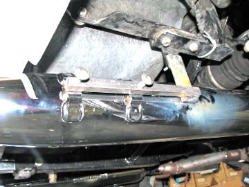

Discussion Starter #18
99% finished with gl1800 muffler modifies to fit on Gl1500 trike. I think you could use this method but use two gl1800 mufflers with the cut out side and modify the ends to fit the gl1500 front end and mount them on a gl1500 standard bike. Those bad welds you can see are only tac welds and I plan to grind them off this winter. The entrance pipes are welded on the inside of the concave end cap.
