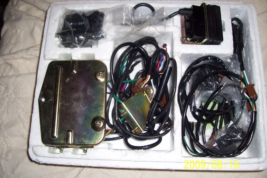

10,509 Posts
Inside the left side fairing pocket underneath the cassette player is the antenna splitter, usually. If the bike has never had a cb installed then the antenna splitter may not be there as it comes with the cb install kit.
Complete cb install kit. You can't see it for the cables but the antenna splitter is underneath the cables in the lower right section. I now have 4 of the splitters, with one being from Sierra Electronics that allows a standard cb PL259 cable connector to hook to it. I got this kit off Ebay 3 weeks ago for 24 bucks plus another box with all the headset intercom cables in it. Everything is new except the actual cb unit. It won't transmit but has very good reception my other one didn't have.

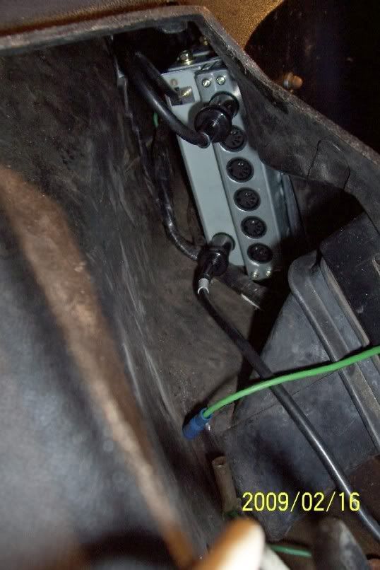

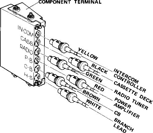

10,509 Posts
The box just forward of the left fairing pocket is the distribution component unit that all the other units connect to. This one is the newer one that came out in 83 with an extra intercom unit piggy backed onto it. In this pic not everything is hooked up yet but now all the plugs are filled on the bike.
