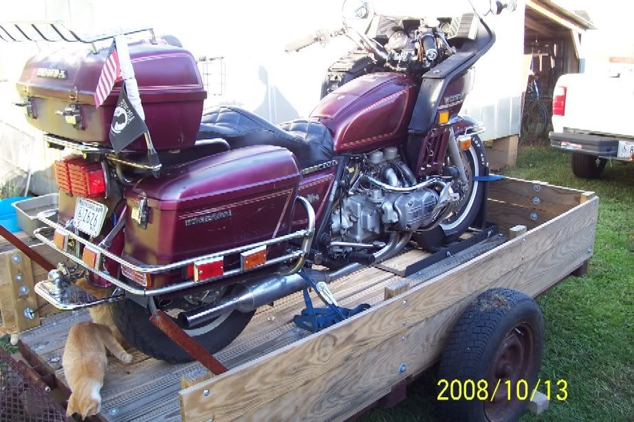

Here's some pics of the trailer i modified for hauling bikes. As you will notice the wheel chock from Harbor Freight is adjusted all the way to fit a Goldwing wheel. I loaded Old Ghost on it to use it as a platform for changing out my rear tire. With a trailer hitch installed the tailgate now will not close all the way to use the retaining straps made for it so I used 2 bungee cords on each side to hold it up. When hauling a long bike I'll use a tie down strap to secure the ramp-gate with.

A little longer strap iron for tailgate security with 2 sets of holes might be in order.
That way with shorter bikes, you can pull it all the way up, and with longer bikes, it'll just hang out at a little angle.
Mike
Thought of that already. Since I'm taking it back up to my brothers for him to install a rack on the tongue for a battery box and the winch mounting plate, I'll have him make a couple of new straps at the same time.
6,947 Posts
Perfect! :)

Yea, my little helpers think they have to be in every shot!!:D:D

MDKramer wrote:
Perfect! :)
Now, get that girl off of there before an HD rider sees it and gives her a complex!
Mike
Don't worry, she's parked right behind the house and can't be seen from the highway. Besides,, the new rear tire isn't on her yet. That's being done in the morning.
Also need to get some fenders and newer rims for it.

The thing I like about the Harbor Freight wheel chock is that it holds the bike upright real well and lets you get your tie down straps on without needing a 2nd person to hold it up. Also you don't need to crank down on the front end as much to compress the forks in order to keep the bike from jumping around and causing the straps to loosen. With this setup you can actually get by with just 3 tie down straps holding the bike down for safe hauling but I usually install a minimum of 6 for safety reasons.

how long is your trailer?
10,509 Posts
Discussion Starter #11
standard 8 ft bed.

You will notice that Popeye's picture shows a 1500 steel frame pulling the hog... I hope that was staged or even photo shopped. That would be a gross overload for a goldwing hitch.

With my 1100 on my trailer right now, the trailer has a negative tongue weight on it. Once i add the battery rack, battery and winch it will have a slight positive weight on the tongue. it's all in how you load the weight on it that affects towing ability and stability.

Bagmaster - you'd be pulling about the same weight as the tow vehicle itself. I'd be very concerned about stopping ability, brake fade, stress on the hitch. I still think that picture was staged. The red car right next to the bikes has a hitch on it, and it's possible that the couple on the bike just backed up to the trailer. You can't see the guys left foot.
