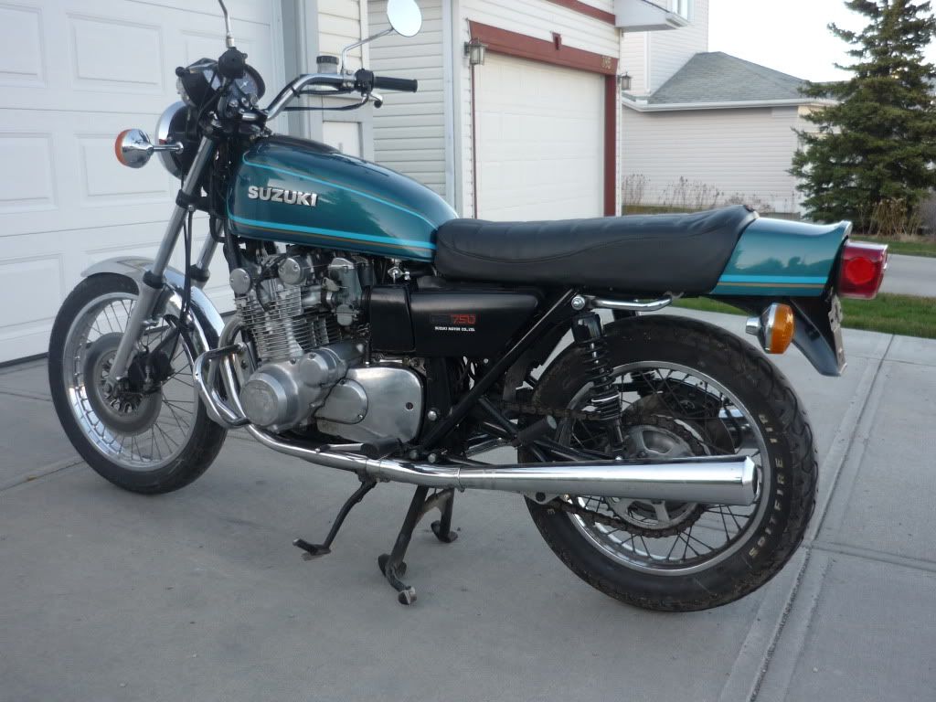

I am thinking of replacing the large plastic, painted front fender on my '82 naked with a chrome one similar to the one on my old GS750. Of course it would have to be wider and perhaps a smaller radius because of the 18" front wheel.

BTW here is a shot of the bike. (Still looking for a nice wineberry red faux tank to match the side covers)
