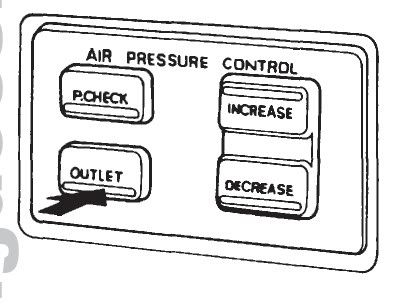

Ok, these are from an 89 owners manual, should be the same for the 88.
Location of air outlet.
Instructions.

I've got an '88 -- nothing about blowing my seat on mine at all ...
The stuff there from Bagmaster's post is all about the onboard air-compressor used to work the rear suspension and provide output to the fitting illustrated -- now THAT fitting is often accompanied by a 10-foot braided (cloth over rubber) air hose that can be used to inflate tires and such.
