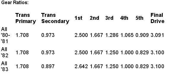

thank you I was begining to wonder if some one changed the final drive out now I will check the ratio verse the book

Negold, the 1100 useda few different (overall) drive ratios depending on the year.
see chart--
Twisty
