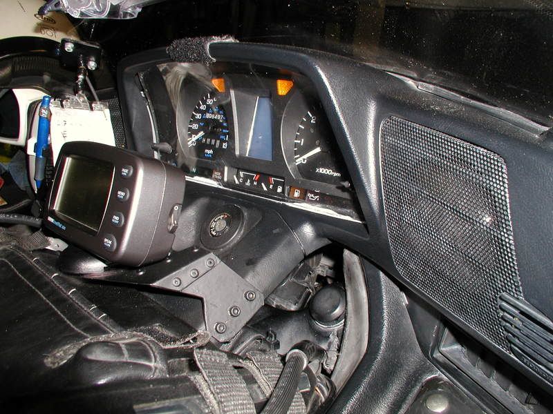

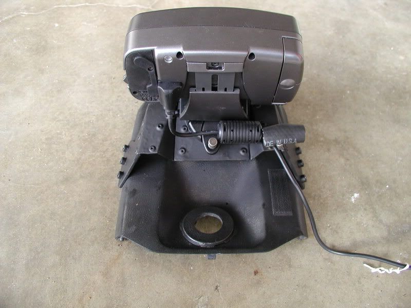

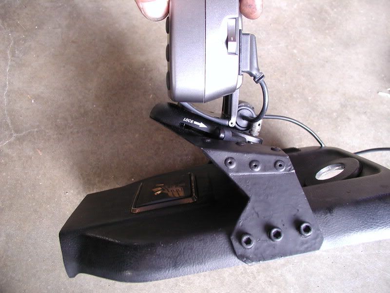

Here's my home made GPS mount... made from some 1/8" thick aluminum bar for the sides, and sheet metal for the top, all riveted together.
Is very stable.
Slight Issue with obstruction of the lower instrument lights, but no biggie as I just lean over every so often to view the fuel gage, and oil light.
