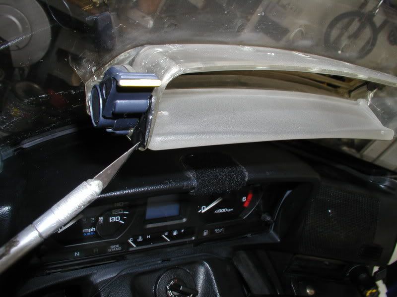

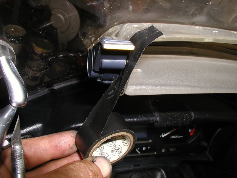

A piece of electrical tape makes the windshield vent operate a whole lot smoother... It reduces the "Indent" that the ball bearing falls into.

Well I've been using this "Modification" for several years now, and it works fine... It's a nice "creature comfort".
I like the tape better than a lube, because with the now-smaller-indent, the vent does not offer as much resistance to movement.
My goal is to limit how much stress is placed on the brittle plastic, due to having breakage on an earlier vent.
