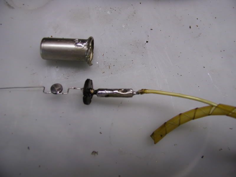

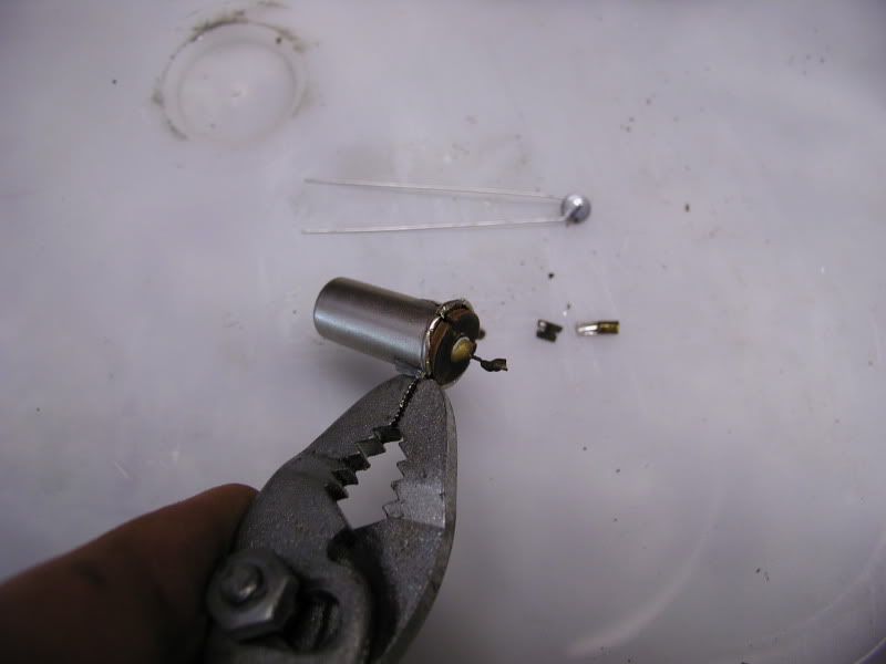

You need to remove the fuel pump, and replace the sensor.
Someone will be along in about 5-seconds to give you the PN for the sensor.... 5-4-3-2-1...

Alex,,,,,,, is that the only way to replace the sensor? Would I not be able to get the whole piece to just bolt/rivet back on with the wire??
Yep, you can buy the entire assembly rather than replacing just the thermistor, but it's about 2-3 bucks for the thermistor and about 40-45 bucks for the entire sensor "can assembly"... For what it's worth, when I did mine, I replaced the entire can at 40-45 bucks...

Easy job.............you can search on this site for "low fuel sensor" and you will find the part number and replacement procedure. Simply involves opening the hatch to the fuel tank, pulling out the pump assemble and replacing the complete little canister with the wire leading off it.

I did a little more researching and discovered that it can take up to a minute or so, for the sensor to react. It needs time to "heat up". So I'll double check by leaving the key on for a bit longer then I did before.
