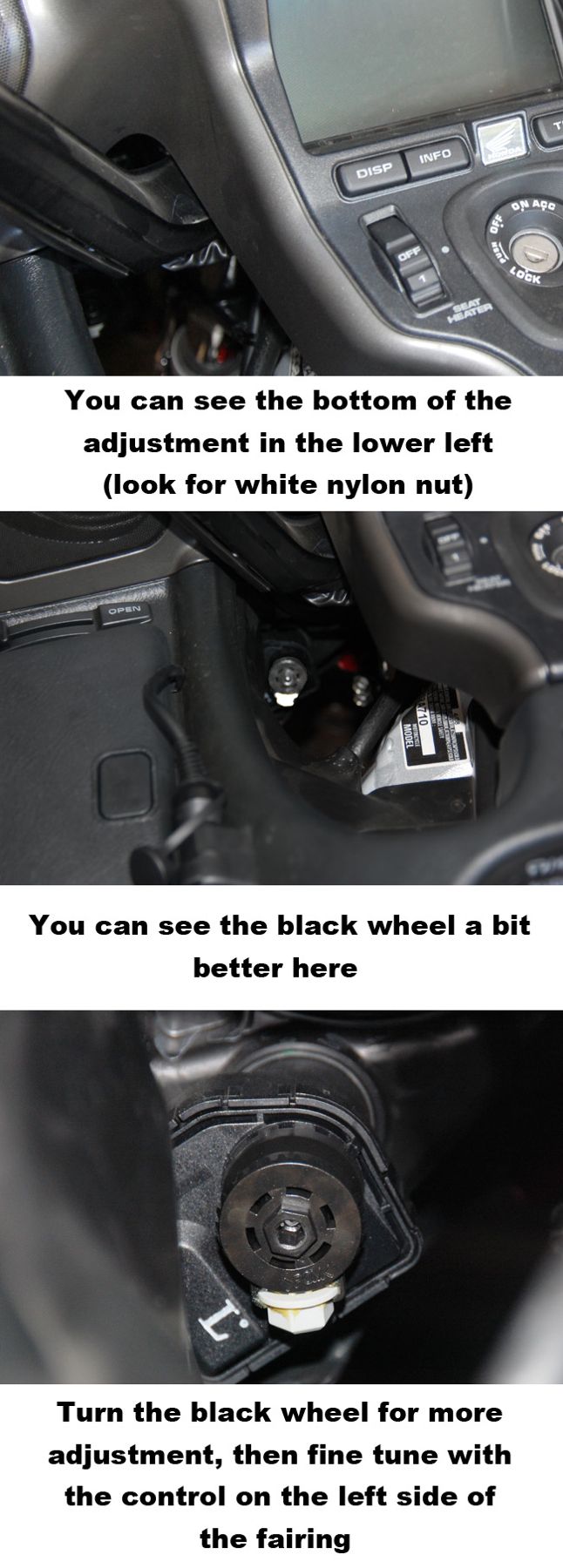

Do you mean extra adjustment on top of whats available from the switch? Is this of any help?;
Thanks...I believe that was what I was looking for...
nice pics Black
You can access that white plastic nut from underneath the fairing with a 12mm socket and long extension. Park 25-30 ft from a wall, in the dark. Get someone to help you, sit on the bike and raise the suspension all the way up. Turn the adjustment knob all the way up and have your helper adjust the headlights up to where they shine on the wall a little lower than the headlight level on the bike. This will give you the maximum amount of adjustment with the dial.
