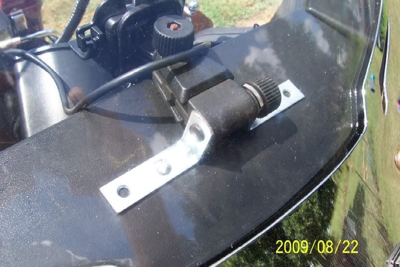

I'm using a Magellan 3000T I got re-furbished off Ebay for 65 bucks. It came with the mobile charger, house charger and data cable along with the software to use it hooked up to the computer.
I just got through modifying the mount for it on my bike by taking the suction cup mount apart at the up/down adjuster and mounting it to the top of my gauge pod using a couple of bolts and plan "L" brackets from the hardware store. Only using 1 bolt on each "L" bracket for now as everything will be moved into another fairing later this winter so then I'll add 2 more self tapping screws in the empty holes you'll see in these pics. The self tapping screws will go all the way through the metal mounting bracket for the gauge pod and make it that much stronger so the weight of the GPS won't flex and crack the gauge pod plastics.
