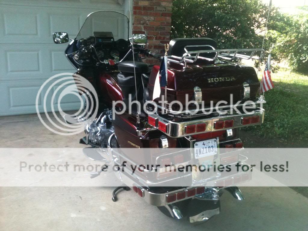

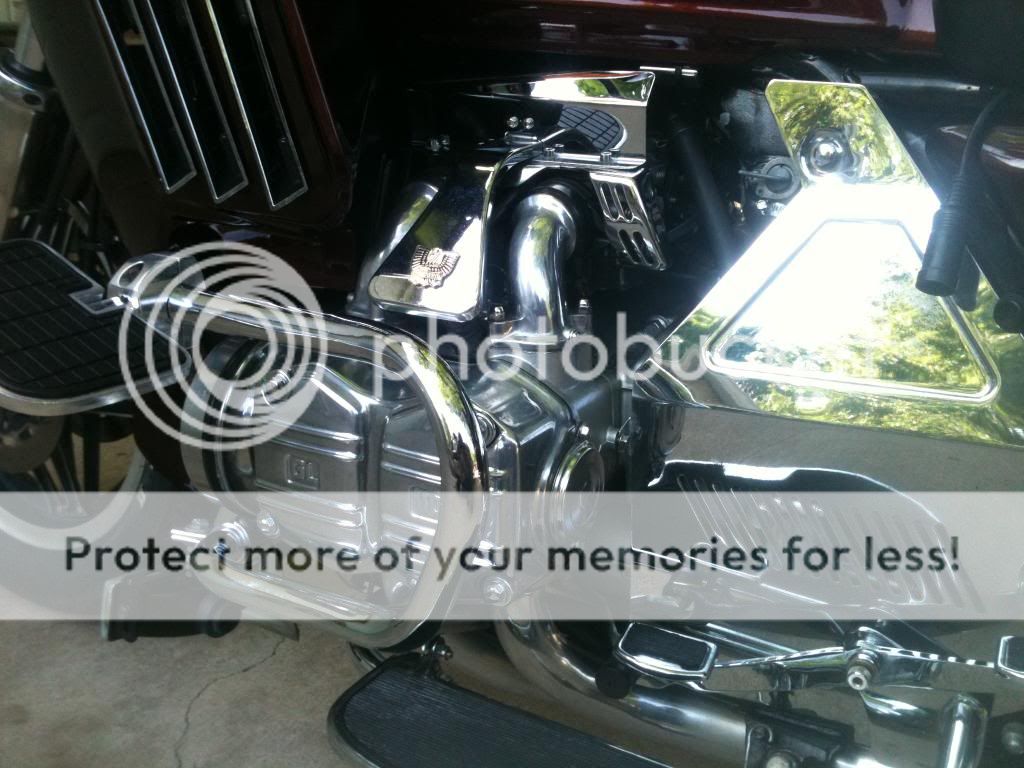

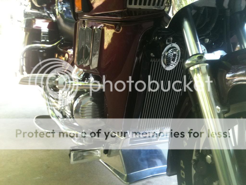

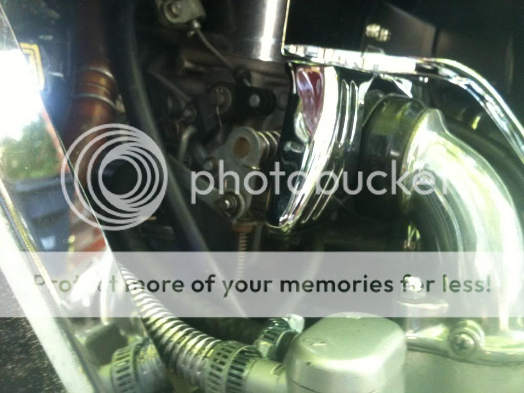

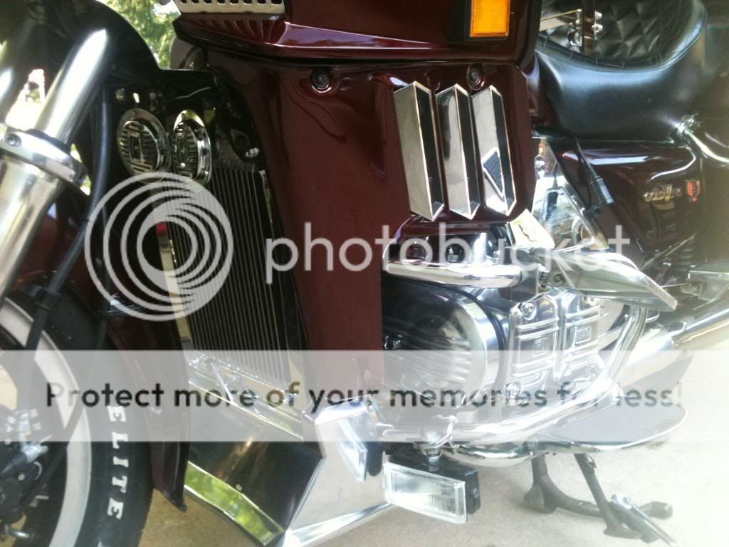

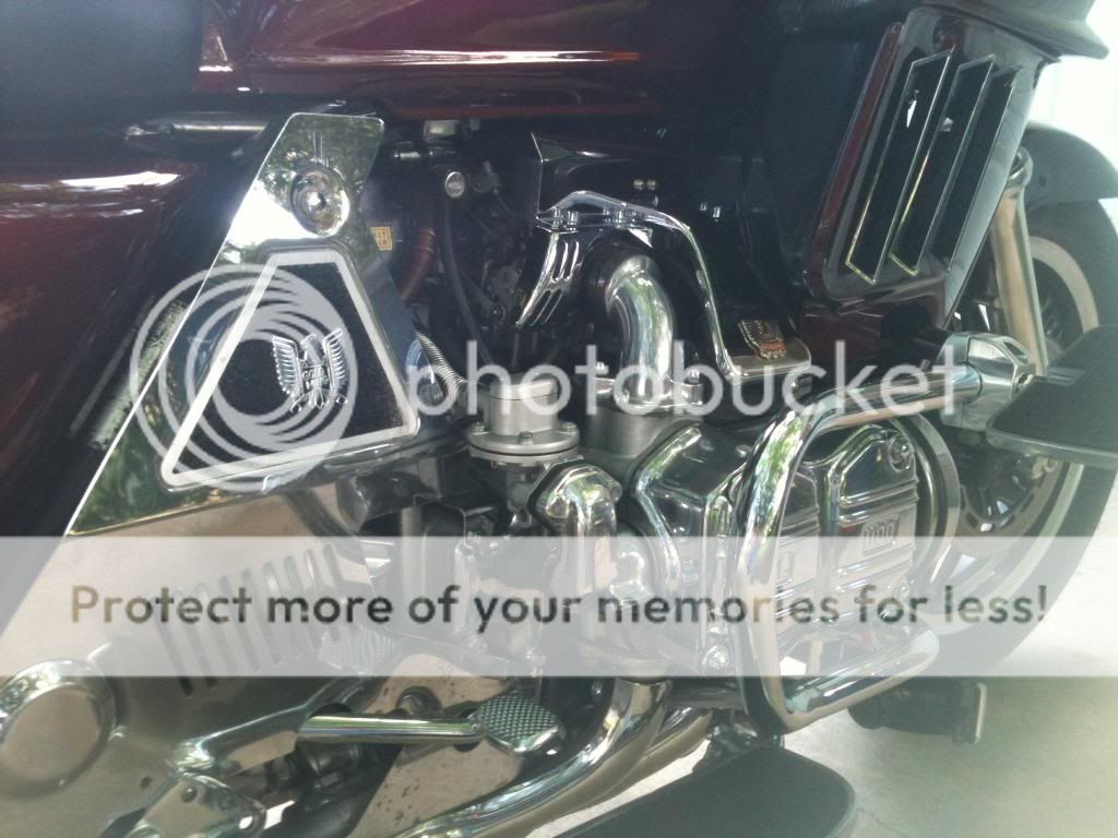

Here are the pics of my new reburbished 82 GL1100, my one eyed girlfriend.
Thing that were done:
Repaint the plastic
All brand new emblems
Sandblast and repaint any metal that was removed
New fuel pump
New water pump
New timing belts
Valves were adjusted
Rebuilt front forks (new seals)
Rebuilt carbs, Sanded with 2000 grit and polished carb slides for easy movement)
Rebuilt rear shocks
New Exhaust
Brakes:
1) front and rear cailpers disassembled and cleaned
2) rear master cylinder disassembled and cleaned
3) flushed both systems
New fluids (oil, anitfreeze, rear end oil)
Aluminum Polished:
1) Valve Covers
2) Timing Covers
3) Back Plate for Timing Covers
4) Oil Filter Housing
5) Transmission Front Cover
6) Lower Radiator Hose Outlet
7) Water Pump Housing
8) Front Forks
9) Oil Filler Cap
10) Fuel Pump Mount
11) Plate Behind Fuel Pump Mount
12) Water Crossover tubes and 90 degree elbows
13) Fork Brace
14) Intake Manifolds
15) Carbs Tops
16) Float Bowls
17) Accelerator Pump Housing
18) Gas Cap (yes it is aluminum)
Replaced the driver floorboards
Replaced engine gaurds
Replaced saddlebag stays
Replaced luggage rack on trunk
Replaced lower driving lights
Replaced windshield garnish
Replaced all weather stripping
Replaced fairing edge trim
Cleaned and polished all the chrome
Added front air dam
Added side engine covers

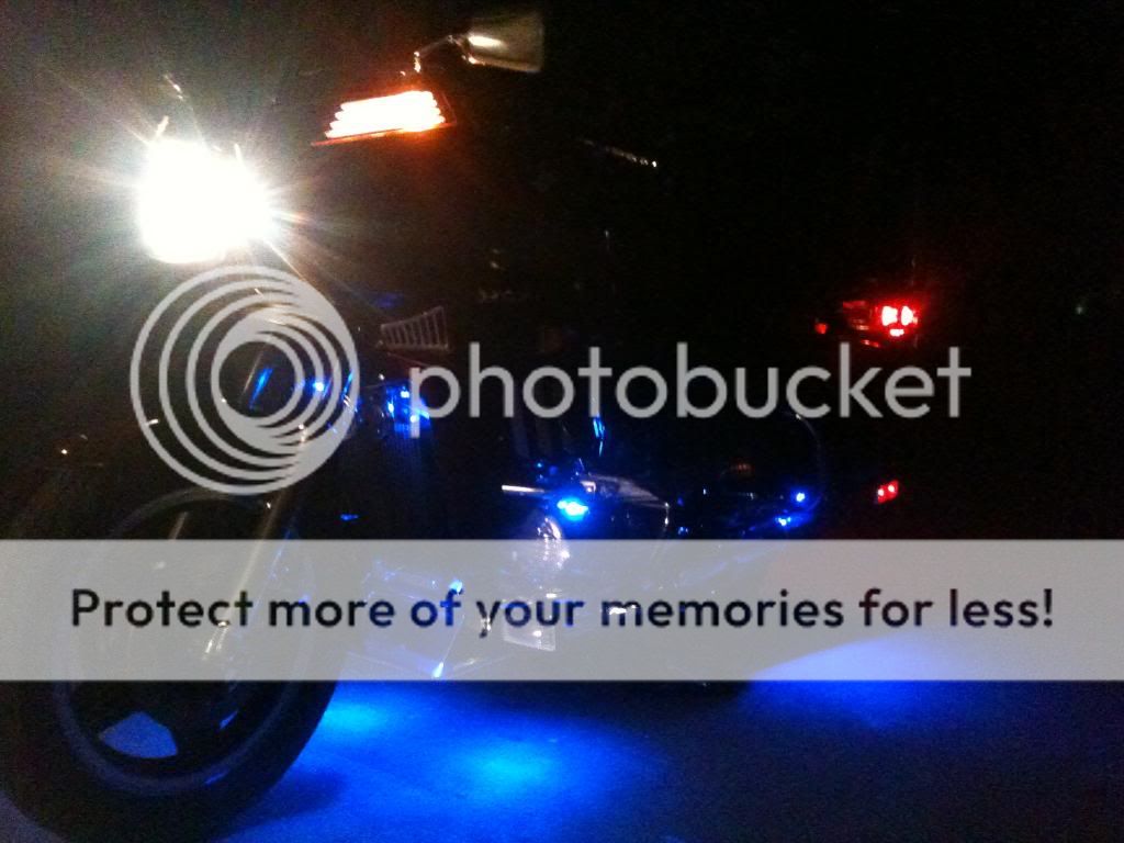

Added more blue LED (Now it has 10 pods. 2 under the saddlebags, 2 behind the front air dam, 2 under the front fairing shining down on the radiator 4 shining into the engine compartment)
I have the Aspy trunk bags (thanks Boborama), they are grey need to dye them black

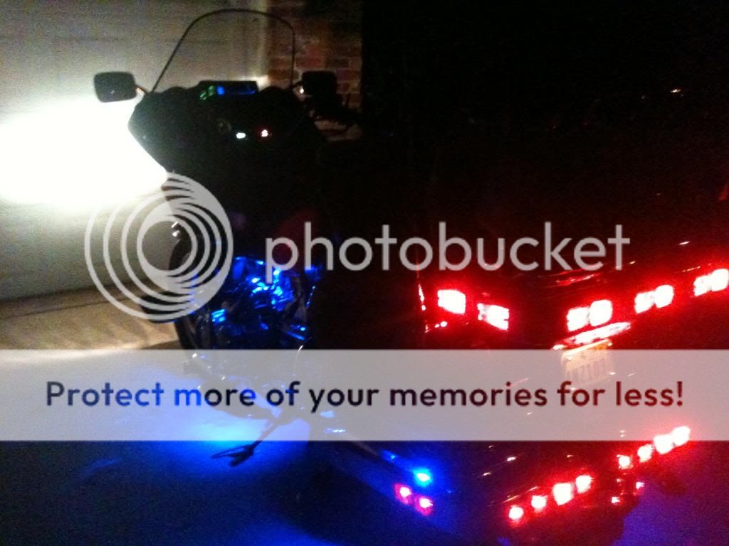

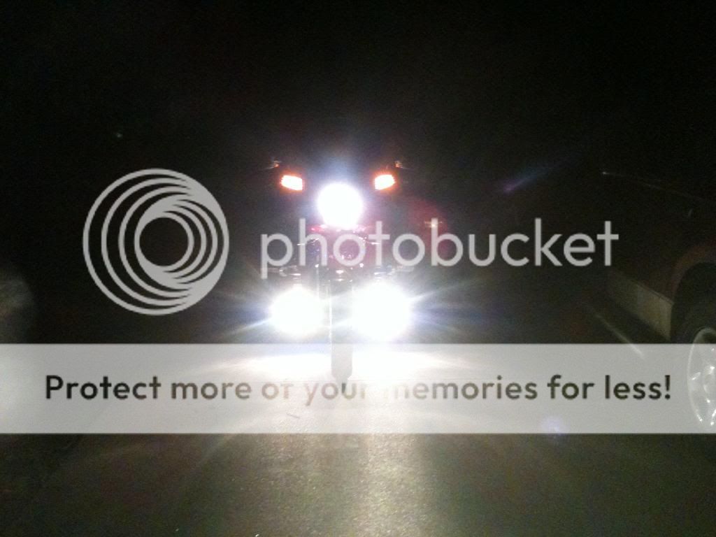

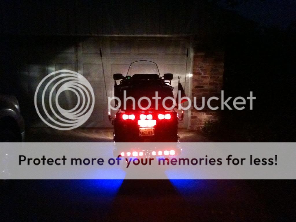

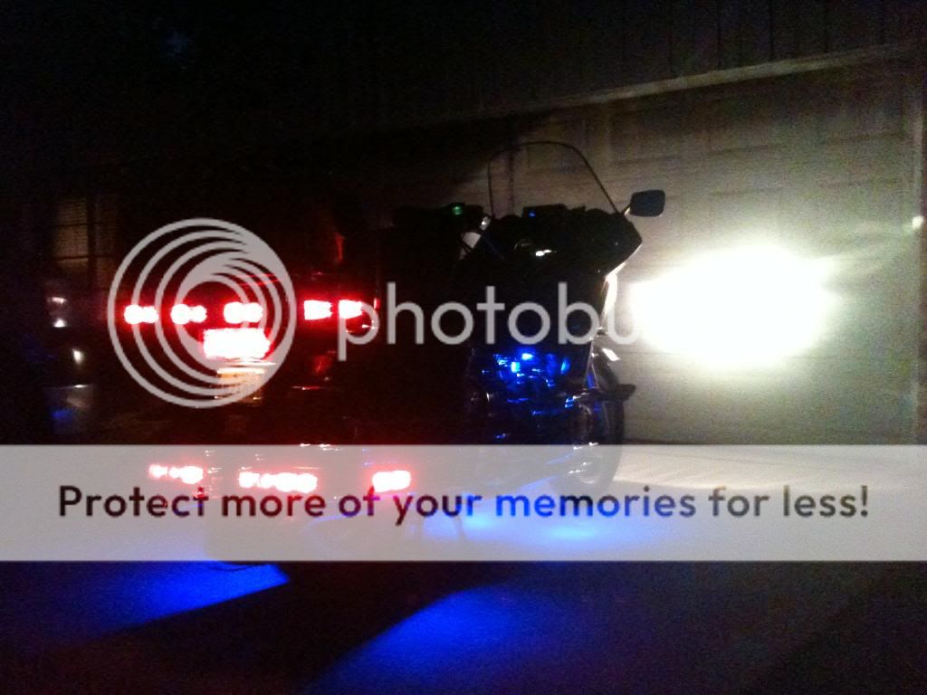

Here are the night pic's

Brian that is a beauty! What shade of red is that? Looks great... I am sure someone is smiling down!
Custom mixed "Wineberry" $300 a quart
After it gets dark, I'll take some night pic's of her all lit up.

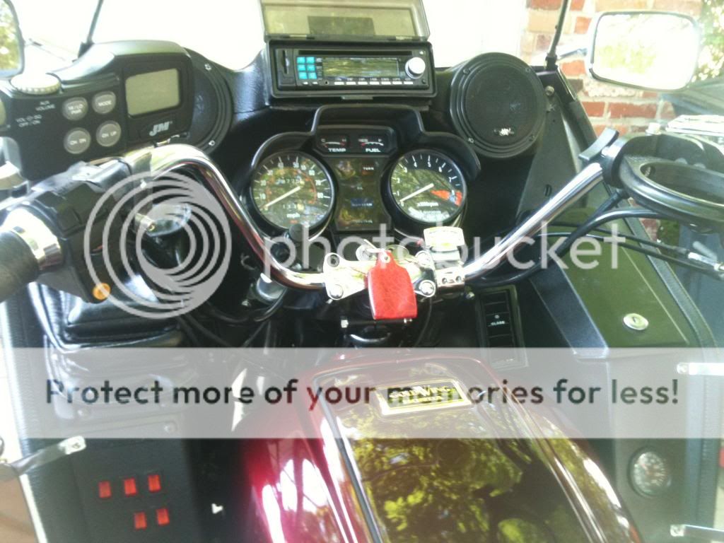

looks great. looking at it, you also replaced the radio and speakers. what did you do there?
