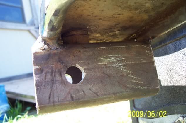

It appears that the plate that hitch is welded to will come off with just 3 bolts. Fight a piece of good flat steel and duplicate that plate and weld a inside diameter 2 inch square tube to it, bingo, 2" receiver hitch!
Here's my home made 2" receiver.
Do like Bagmaster suggested, except just remove the existing plate
that is held on with the three bolts, grind off the safety chain
loop and grind the area flat. Cut off the hitch on top. Then weld
the receiver hitch tubing to the underside of the plate. Or......, drill
a hole in the plate and mount a standard trailer ball.
Unless, of course, you want to keep the heim hitch intact. Then do
exactly what Bagmaster suggested.
If the heim hitch type is suspect at best, then you're not losing
anything by using the original steel plate.
IMHO
