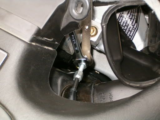

With the help from regor @ http://www.thehubers.net/goldwing/cruise_control.htm, I fixed my cruise control lag. Why Honda doesn't do it, is beyond me. I had to back mine out about 4 3/4 turns, & now it's almost instant. Below are three pictures I took. And to keep from losing the wrenches down the hole, I tied them together with an old shoe string. To give those of you, who are still unsure, the rubber gromet is just to the right of the ignition switch. Oh yea, after I took off the dash, I took out the screws on both sides of the ignition switch. That way, I was able to pull the plastic piece back, to get to the cable. That's the plastic piece pulled back, at the right side of the picture. After the work is done, just put it back, where it belongs.

Well done Verdayne, they are the clearest pictures I've see of this job yet and should make it easier for anyone attempting this. When I did my own it took 3 full turns before it worked the way it should have from the factory. Of course I didn't have a camera with me that day. :?

I have just torn my 2001 goldwing down by using my service manual trying to adjust the cable on the cruise actuator. I can't find the hole where the service book shows to adjust and line up. I hate to put it back together without adjusting it like it is suppose to be.Do you have any idea where it is located and what it looks like. Thanks Don
