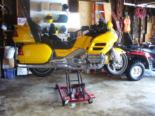

I am trying to lift my 1800 to replace tires. I have the larger of the 2 Harbour Freight M/C lifts. It looks like I can hit the frame rails in front of the center stand, but what do I hit behind it? There is a plastic tank under there that I clearly want to stay away from. Looks like the bottom of the engine is not flat either.
Any help would be much appreciated, as I am hopelessly stuck.

I don't have a HF, I have a Pitbull.. On the Pitbull, the rear lift bar goes under the center stand pivot point, and the front kind of ends up about where the kickstand is. The HF is probably similar, but I would like someone with one to respond with definitive information..

thanks for the reply Dave. Do you put the center stand up and put the rear lift bar under the collapsed center stand?
Joe
nsjoe wrote:
.....Do you put the center stand up and put the rear lift bar under the collapsed center stand?
That's how I do it with my Pit Bull.
that's a great picture Jeff. I'm not sure if the arms on my lift are wider than yours or not, but I just couldn't seem to get a spot where both lined up under something solid. I'll take a look and see if I can duplicate what you've done.
