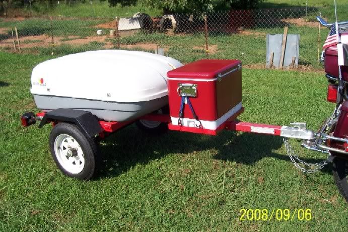

Here's a good shot of mine with the tongue extended for the addition of the removable cooler rack.
Here's the rack on the receiver adapter.
