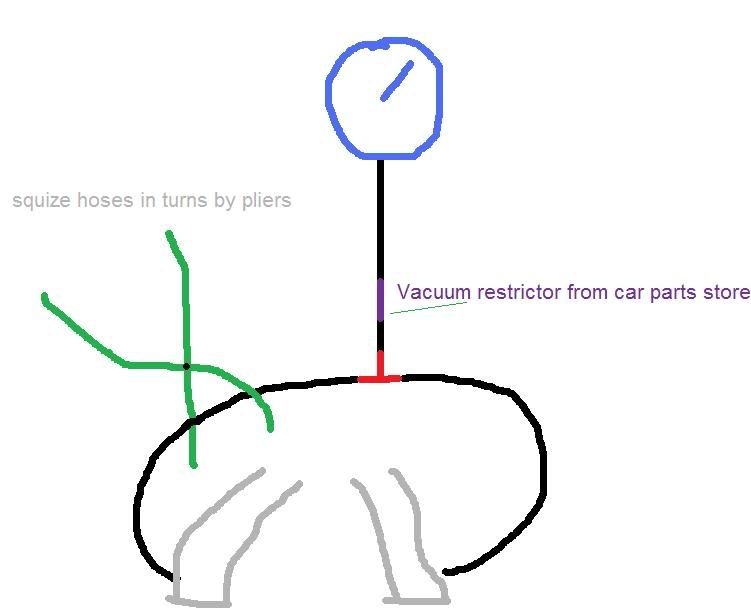

To synch the carbs I would tend to say you need two individually ran vacuum gauges to get an accurate reading. or a liquidfilled manometer,I use antifreeze. There's plenty of old post on this site.
Nothing wrong with his design, and in fact the most accurate way to sync the carbs is with a single gauge - because there will never be any error between the gauges.
If you use several gauges you have to sinchronize gauges first!:)
