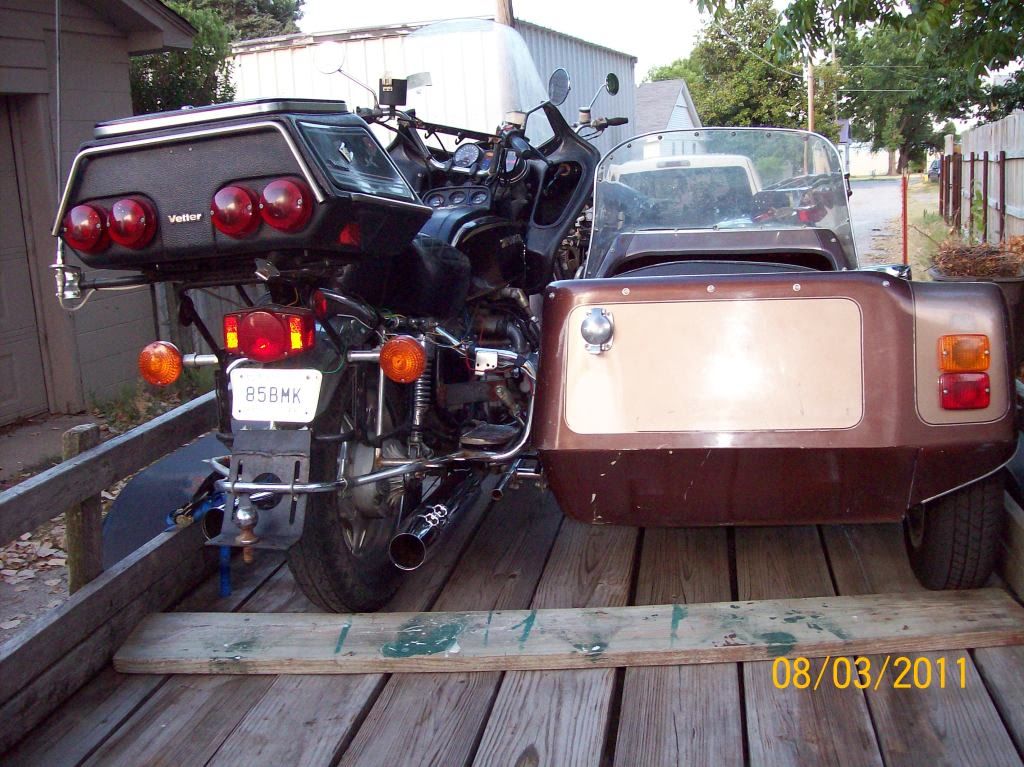

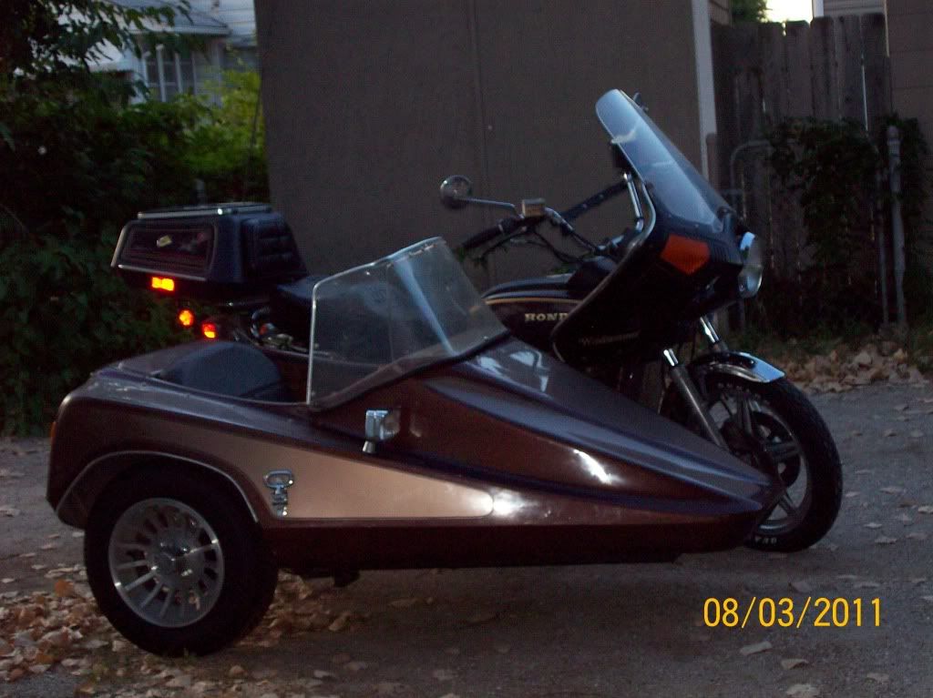

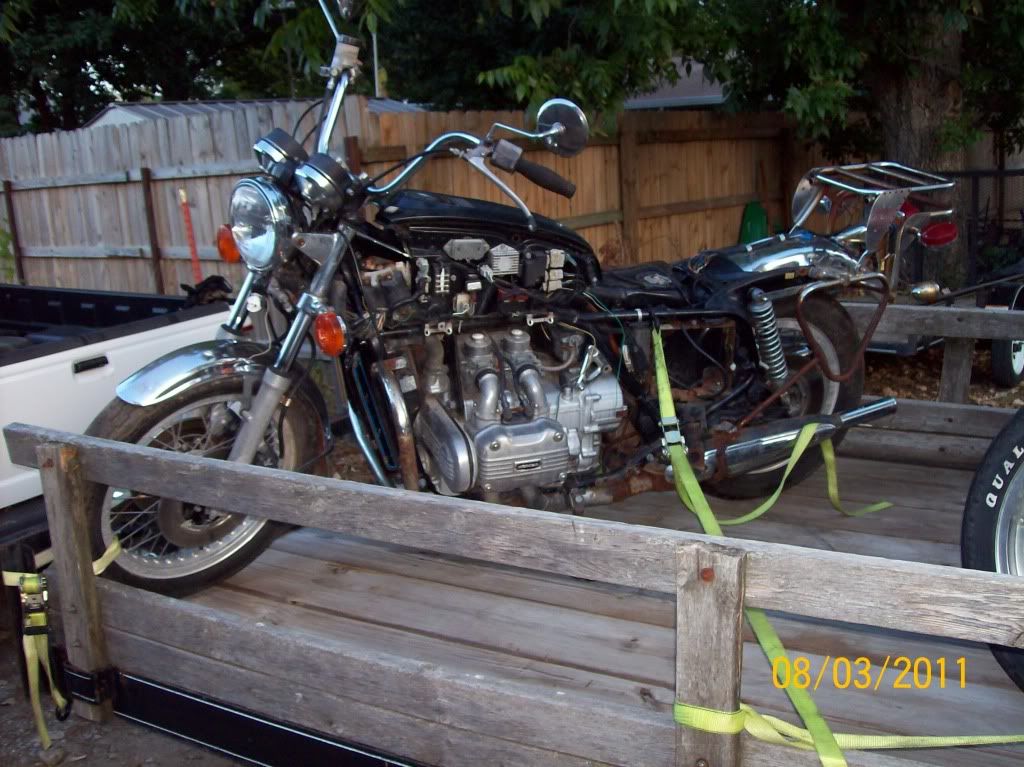

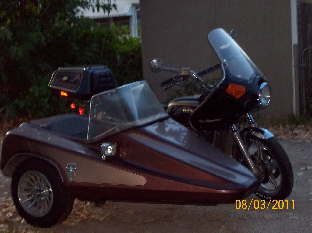

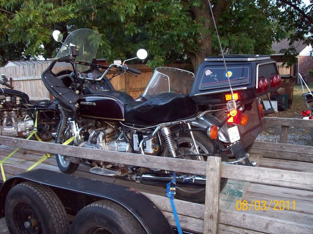

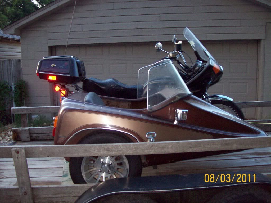

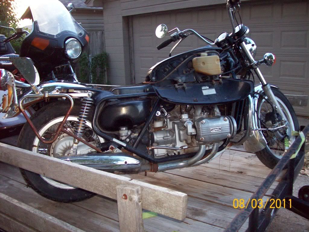

Found a 78 with single carb(Cycle Innovations single barrel Holley) and Motorvations Formula II sidecar, PLUS a 77 parts bike in Independence, KS. Just picked them up yesterday evening. The sidecar came with the convertible top, manual lean system, and fuel system. The 78 runs but needs some cosmetic work. I also think the carb needs rebuilt. I'll have to figure out what the carb model is. The 77 is missing some parts, some of which are on the 78. I also don't have a title for it. If I could get a title, I could make it a running bike. I have most of the parts needed for it.
Here's some pics from when we got it here yesterday.

You betcha! Hopefully, I'll be putting everything from the 77 into a titled frame. I have most all the parts to fix it up. The 78 runs now. I'll work on the cosmetics and rebuild the carbs this winter. I want to remove the floorboards and heel/toe shifter for now. It's a really lousy setup. Real hard to shift. If the heel/toe was a decent one, I'd leave it on there.
