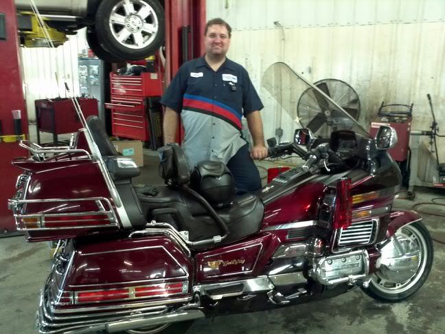

Pic of my ugly mug and bike;

Congrats on the ride, she is a looker. For sure, check for a vacuum leak. The symptoms described for driveability concerns would also cause the vacuum operated cruise to not function if it did have a bad hose.

:waving: Welcome to the site. Nice ride. The 1500 folks will chime in soon.

Welcome to the forum and congrats on the nice looking ride....... One of the 1500 folks will chime in soon, most are probably still out riding..

Nice looking bike there. Obviously someone took care of it, and it wasn`t abused. I would start checking the cruise control operation ny checking the brass pivot on the clutch handle. Should be round. Should hear2 clicks when you pull front brake lever.(If you have aftermarkket levers, that could be part of your problem.)

thats a wig on fire! look.....need progressive fork springs

Thanks for all the welcomes and comments on the bike. :eek:)

That is one sweet lookin' GL1500!

Sweet looking ride !! :cheesygrin:

That is one sweet looking ride you got there. I can only hope I can find something like that. or close to it. good luck with it and ride ride and ride to your hearts content.
