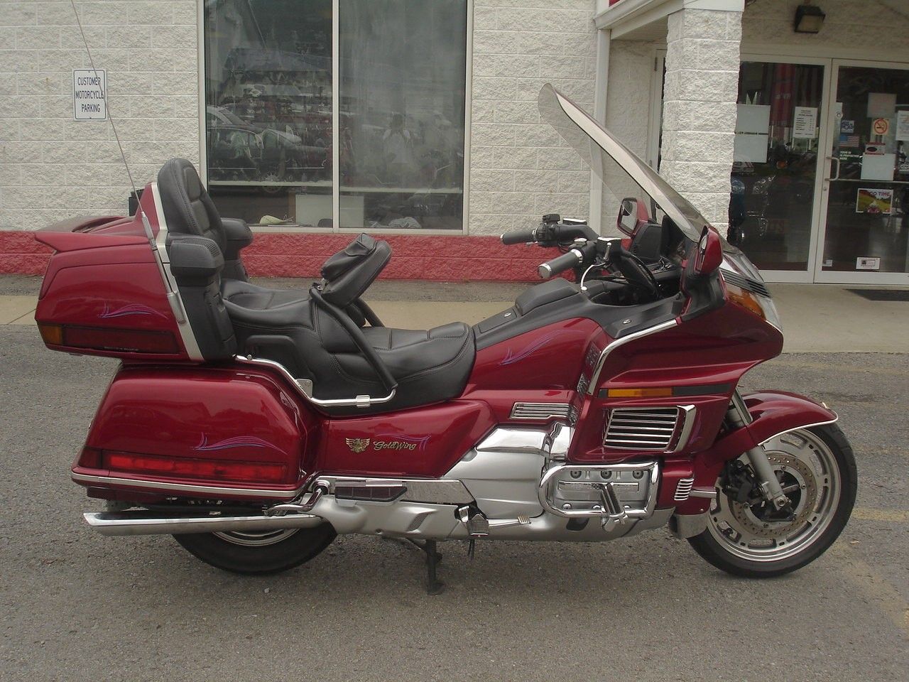

Well, after three long months of looking for just the right one I think I found it. It's about 5 hours away but if the description and pictures are anywhere near correct, I think it's a fair trade. It's a little older, a 93 Aspencade but it only has 26k on it. One owner and has been meticulously maintained the bike. All the records come with it and has a host of new items like timing belts, battery, alt, and tires. All the usual's have been done oil, filters, etc. A few shiney parts have been added and a tall windshield with the vent. Even trade for my Vstar and he'll pay the transfer fees. I go pick it up Sunday.
Sorry about the long time before the update but I'm the kind of guy that researches something to death before plopping down money. Sometimes it works great, sometimes I miss a good deal. What are your opinions guys?

That looks like a sweet bike. You're gonna love it!

If it runs out good, shifts (all gears) Well, and you are happy with the deal, Then I think you have found your wing!!
If I was looking at that wing and all checked out and the owner wanted $4500 for it, I would make that deal.
Make sue you get the belts changed!! If you don't know the age of the new ones coming with the wing, trash them and buy new ones, a set at NAPA are under $40, don't chance it.

Looks good. I had a '93 that I sold with 175k miles on it and it was still running and shifting like new. There's a fellow near here who has almost 400,000 miles on his '93 so they can last a long time.
The only odd thing I see on that bike is the angle of the pipes. Looks like they're aimed downward for some reason.
One thing I'd do to that bike is take a saber saw to that Tulsa shield. I really don't like to ride a bike that has a windshield that I can't see over the top of.

Check out the pipes on this 1500. The ones on the bike you're looking at look like aftermarket pipes or at least the ends are. But I've never seen any at that angle.

Those slash cut mufflers look to me , to be HD take offs . From the info you post it sounds like a cared for bike .
Take a little empty parking lot time to get used to the bike . When I first rode my 1500 it has a diffrent feel from other bikes at low /stopping speeds . Its not bad , just different .
Oh , and dont take both hands off the bars while slowing down . Between 40ish and 30ish it has the ability to get a wobble with no hands on the bars.Yours may or may not do it . It seems to have a few causes such as tire wear and headstock bearing adjustment .

I had a 93 and it was a great solid bike.. If you're concerned about the alt, just get a volt meter and keep an eye on the out put.. That will let you know if your going have any problems ahead of time..
The one thing I'd say is the 1500s like a good strong battery ......

Makes sure it shifts good i believe the 93 had the bad shifting forks in some of them? and those are HD take off pipes the reason for the angle i'm sure. strange that the stock pipes would have rusted out already. may have been damaged or something. check the title make sure it's not rebuilt and the mileage is correct.
the black trike i just got is a 93 with 117000 and it runs awesome. I think you'll have a great bike there and will last you a long, long, long long, long time.

I suspect the bike was owned by someone who wanted more noise. My '93 still has its original pipes on it and the new owner has about 190,00 miles on it. The pipes still look good with shiny chrome, no rust visible.
