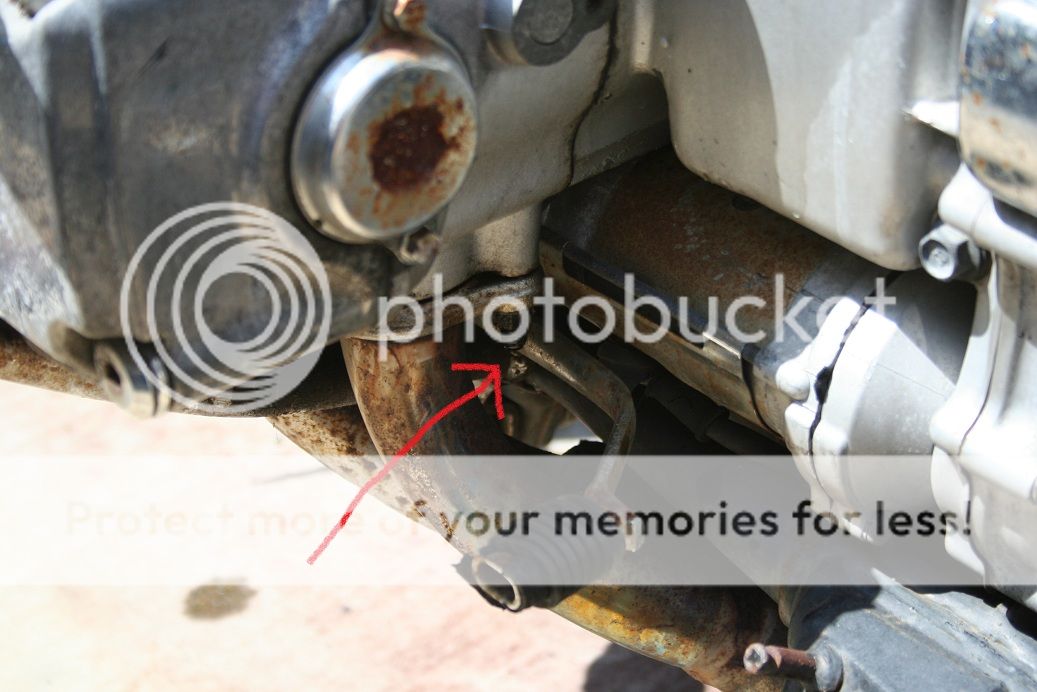

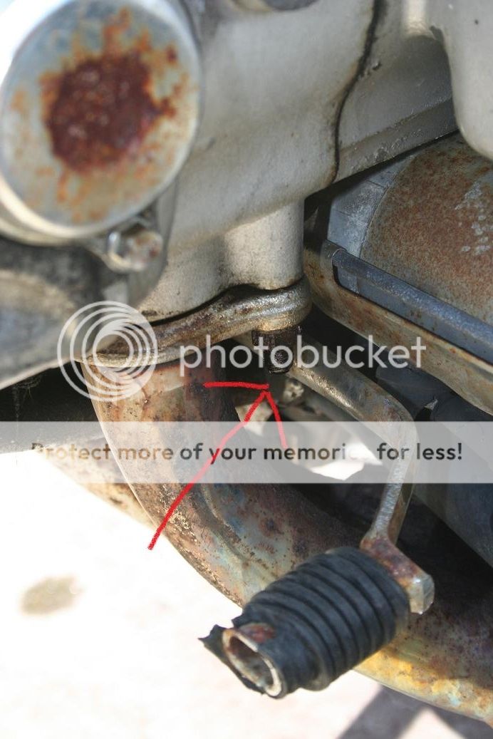

I am resurrecting an '84 Interstate, and noticed an oil leak on the left hand side dripping off of the exhaust bolt here while running it yeesterday:
After a search here, I found that it might be the valve cover; however, an inspection of the cover & such revealed no leak. Any ideas?

Shift shaft seal. Very common.
Thanks! I figured it was something simple and common. I'll check that tonight.
