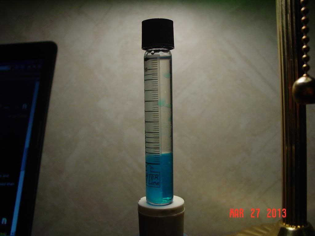

For the curious:
The wateer is filled to its line with the bottom of the water bubble at the line.
Then fuel is filled to the top line in the same way; bottom of the bubble to the line.
The tube is then shaken vigorously for a few seconds to promote a good mixture.
...settled after a couple of minutes, the heavier water/Ethanol solution sinks to the bottom of the tube and sits there for a reading.
Rotate the tube so a accurate measure can be had visually. In this case, the "Get-N-Go" just outside of my neighborhood has E-10 in individual hose pumps. I bought 2-1/2 gallons worth this afternoon and removed a sample as soon as I got home.
The blue comes from approximately 1/2 drop of blue food coloring.
The labels on the tubes are scaled for volume.
The labled grade at the pump was E-10 and is shown to be such according to the tested sample. The true alcohol content is approximately 9% by volume.
In "5 Easy Steps" this stuff can be accurately tested at the pump.
I'm making a small booklet to show particular details of each step in the form of pictures, ...about 18 or so of them.
I'll just resize most of my current pictures and convert them to black and white so that my laser printer can do it here at the house. The B&W laser printer made the labels on the test tubes.
Black and White pic below should be good enough...
Have decided to ship the tubes filled to the bottom water line with the colored water ready-to-test, ..just add fuel.
Retail packaging will probably have a amount of "Blue Test Solution" in a pre-measured eye-drop style bottle.
Do note, that when witnessed, this blue water/Ethanol mixture sinks to the bottom of the test tube very quickly. It starts moving downward immediately after shaking. This happens in our fuel tanks as well.

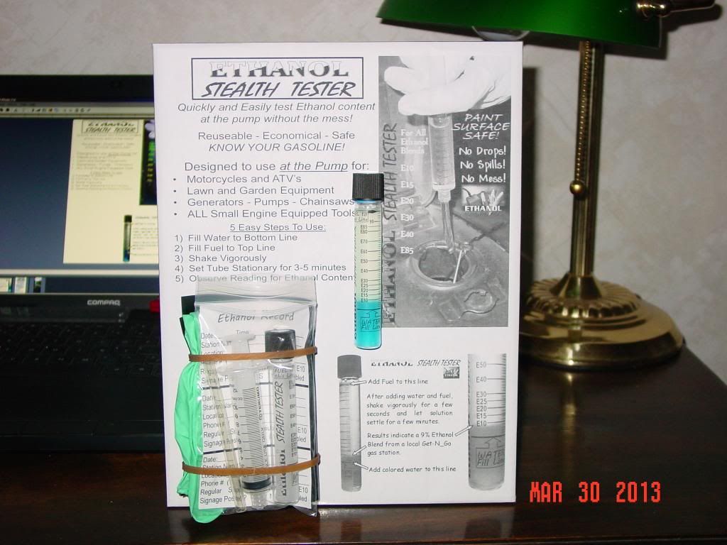

Here is a table-top display I put together last night for this weekends motorcycle swap-meet here. It shows the kit on the bottom left and a test-tube of an actual sample from a Get-N-Go gas station outside of my neighborhood offering E-10.
The label says, "Up To 10% Ethanol".
The tested sample shows 9% Ethanol.
In the kit:
..Black, foil-lined, food-grade ziplock bag holds everything. Odor, leak and fuel-proof.
..A pair of nitrile gloves.
..Threaded glass test tube with screw-on cap using a rubber seal resistant to petroleum products. The tube is scaled for volume measurements (given in percentages) based on a ratio mixture of water. Very accurate. 0-100% Ethanol.
..10ml Syringe that can be taken apart and cleaned with dishsoap and reused many times. A 3-1/2" pvc extension tube for its Luer-Lock end is used to draw a sample from a freshly filled fuel tank. Removing the extension tube to fill the test tube has the syringe Luer-Lock tip and the test tube opening being a perfect male/female, fuel-tight fit. No spilling, no mess.
..Test tube, syringe and extension fit into a smaller poly bag containing a playcard of instructions for use and a record of use on the reverse side. A rubber band holds it all together snug.
..The test tube comes pre-filled with dyed water at the correct level. Simply add fuel to test. A poly bubble envelope is used to ship, for transport and additional protection after received by purchaser.
I'm not beating them, and I'm not joining them. I don't want my bike drunk, so this is what we gotta do. If I can't drink the stuff, ...then neither can my bike.
