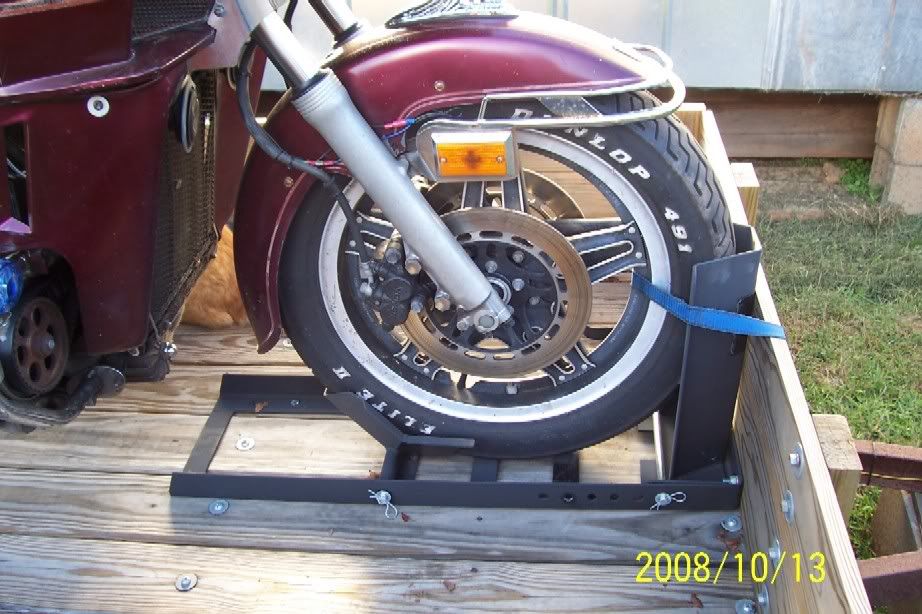

I also have my front wheel in a chock. And I have two pieces of 2X4 screwed down, on each side of the rear wheel, to keep it from sliding.
Front wheel chock with strap, 4 ratchet tie downs and I'm ready to roll.
This is just from moving it around in the yard to use trailer as a work stand for changing the rear tire.
Is that the chock from Harbor Freight Bagmaster?
Do you like it?
Do you like it?
Yeppers and I like it quite a bit. I just wish the adjustment holes had been drilled in the base for the rear piece and not the front piece. Doesn't matter much anyways as with it adjusted for the largest tire is what fits the Wings best anyways.
