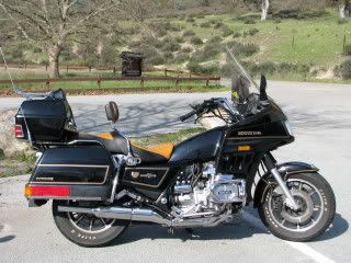

I am at least the third owner of a (new to me) 1986 Interstate with 33K miles. The previous owner had little English and I had no Spanish but I understood he bought it at an estate sale. Having read of the electrical issues this model is prone to, I mounted an LCD voltmeter (wired directly to the battery) to the dash and have been watching it for over 1000 miles. The only extra electrical draw is for a pair of Gerbing heated gloves which I use rarely ( < 1%). I have observed idling voltage is always greater than 14V and cruising (3000 rpm) voltage is always fluctuating between 14.7 and 14.9. I am afraid it will "cook" my battery but it has lost no water in 1300 miles - so it doesn't seem that it is. On a related note: I will eventually replace this with an Odyssey (maintenance free) battery. Aren't these batteries more able to tolerate higher voltages?
