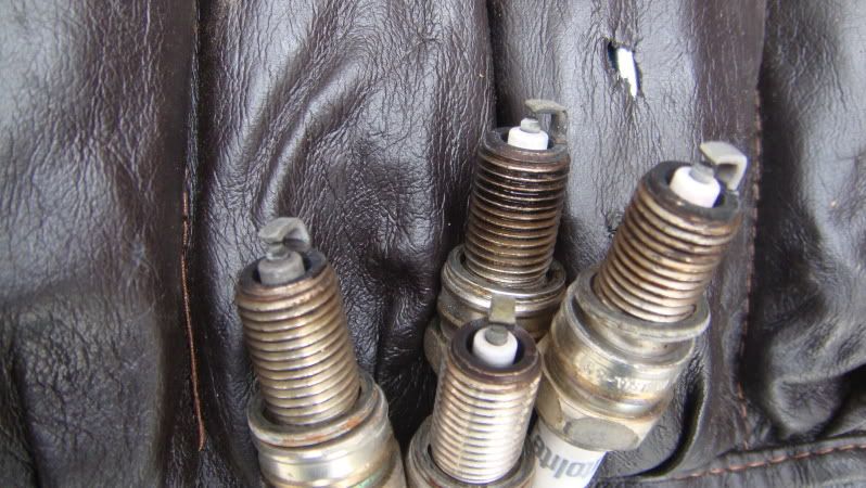

I am loosing antifreeze and over heating...................................again!!!

oem parts, the heads were checked at a machine shop, everything was torqued by honda manual. bike was running great for 4000 miles. on a pgr trip to morehead ky i started smelling antifreeze and the temp went up, when i got there i had to add three bottles of water. on the return trip i stoped about half way and added another bottle. as soon as i got home i let the bike cools for about 15 minutes and pulled the plugs. i let the bike sit for another 15 minutes and then covered the spark plug holes with cardboard and cranked her over. Nothing there.
Nothing in the oil eather but everything else says head gasket. loosing antifreeze, running hot, clean plugs.

3 white plugs VS 1 carboned plug could lean to water in there . I would have a hard look at all other plumbing for a leak . Is the exhaust smoking white or dripping from the drain holes ?

i am always up for suggestions. even if i get the over heating under control, i still have to work on the three lean plugs. I bought this bike was 92000 on her, she now has 97500. when i first got her i replaced the head gaskets, water pump, thermostat, (180deg stant) hoses and plugs that are pictued. I am getting right at 40 mpg ridding alone and about 36 ridding 2 up which i do a lot with the wife. Mabey carbs next?!?

That's normal mileage. The carbs are probably fine. The mixture screws may be out of whack, causing the plug conditions. Try an idle-drop.

I'm not a mechanic but, I would think the torque wrench theory might be right. Study the picture carefully and you'll see there is a varying degree of oil on the threads of the sparkplugs on every one.
Perhaps the sparkplugs weren't properly torqued....
Just my two cents....
