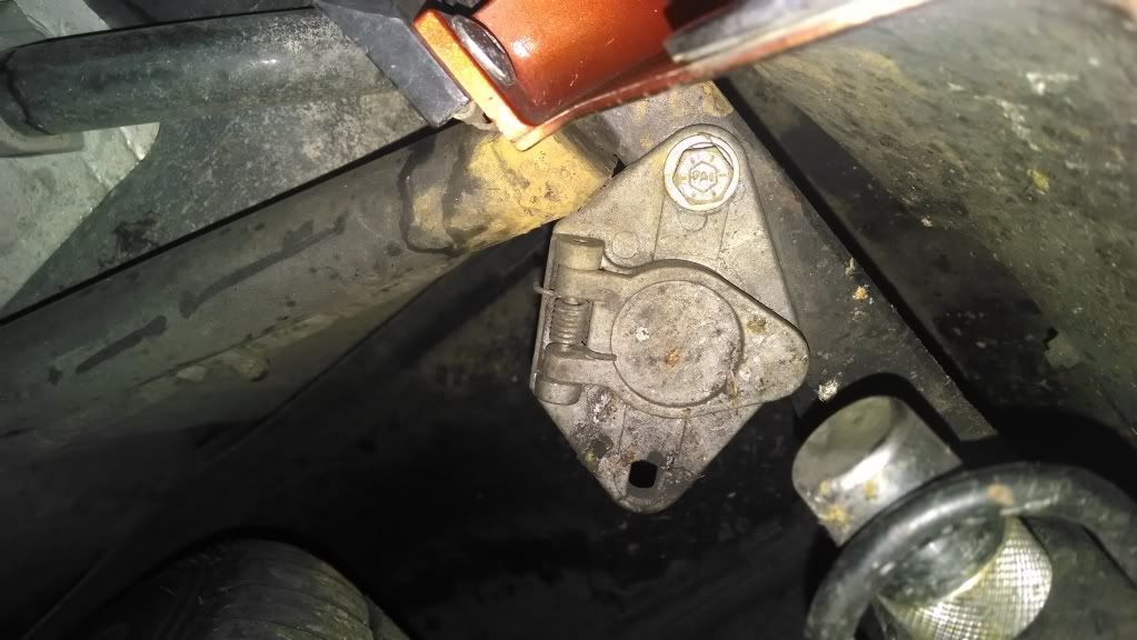

I mount mine behind the fender so it's out of sight all the time. It's bolted to the trailer hitch.
