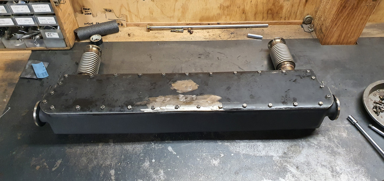

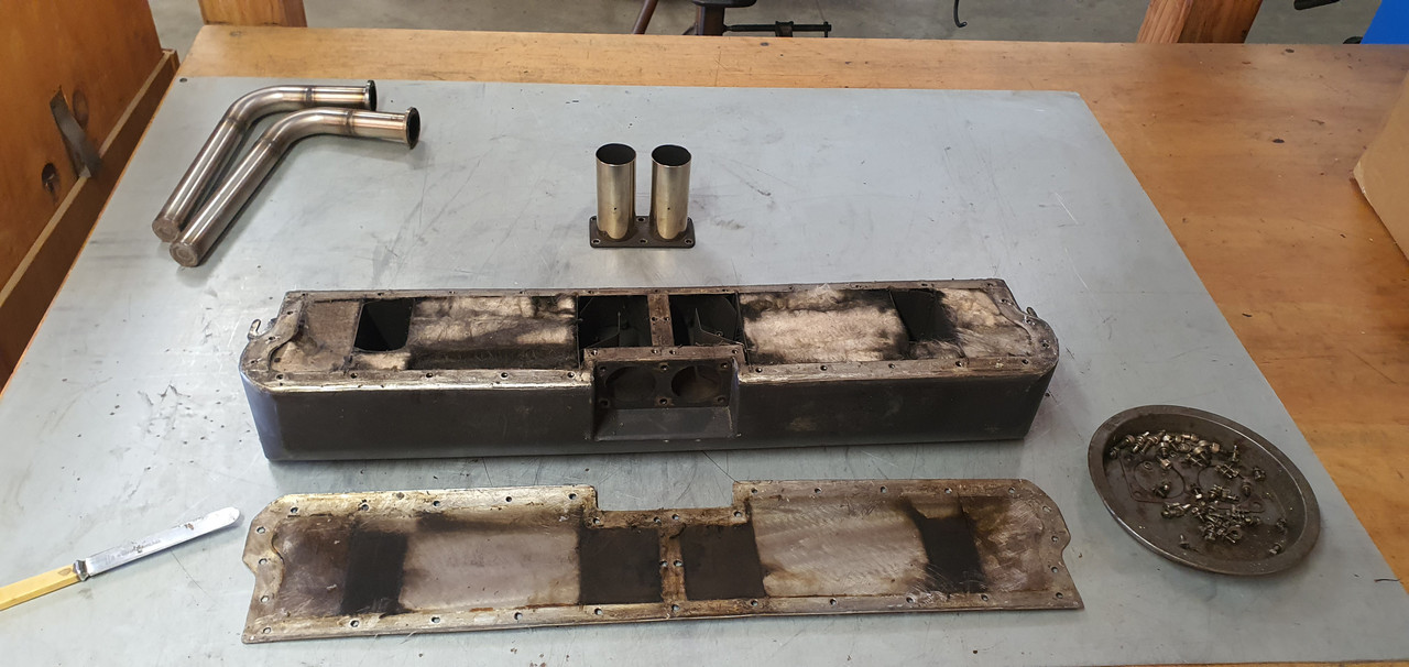

Its about time I build another exhaust box. Here comes version 3.0
First I brought version 1.3 in from the garage. This box took me ages to make. Quite involved. By the time I'd got to 1.3 it was pretty good for sound but too fumy with the centre exit exhaust and not flat sixy enough. I took the lid off and looked inside.
Then this happened.
No going back now. I welded in some stainless to cover the hole created when removing the centre exits. It was now a simple box again and ready for filling. These arrived in the post all the way from China. I'm constantly impressed with the quality of these. I got eight of them landed for not much more than the price of one at 'trade' from my stainless supplier.

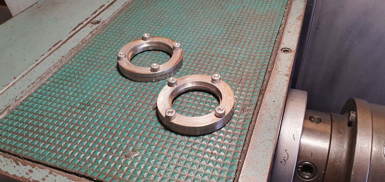

Before playing with elbows I machined up some more flanges for the new tailpipes. These were later welded onto the outlet stubs at each end.

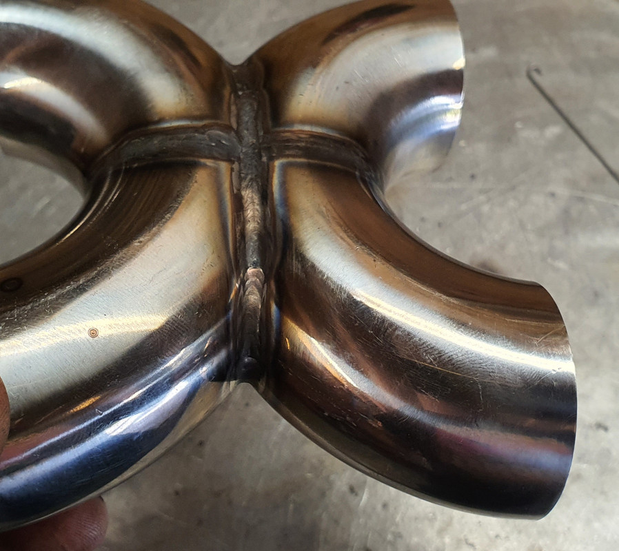

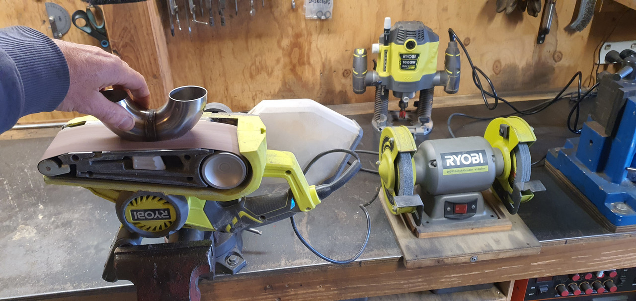

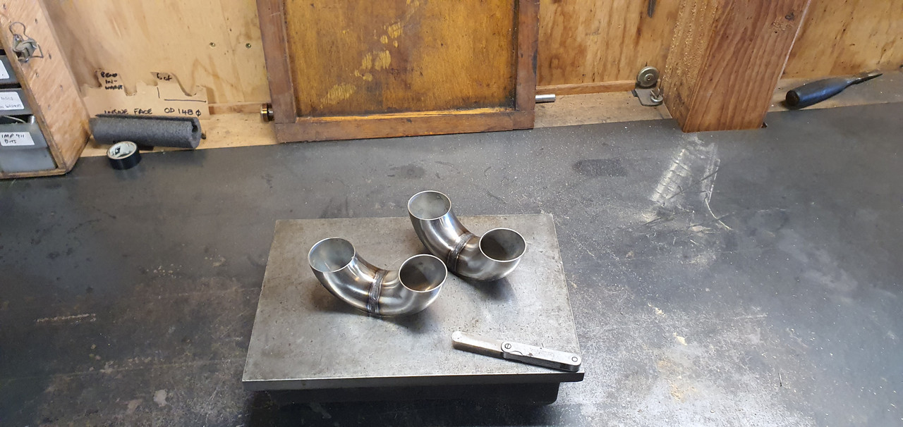

I welded two pairs of elbows together, cut the outside of the curves off and then fired up the yellowhammer workshop Ryobi precision material removal machine centre..
I was so impressed with the quality of finish this machine creates even after checking on the surface table..
Wow. Amazing. I'd made sure to check all other possible measurements..
Then welded it the halves together. I was very happy with how the welding was going..
But got a bit slack and a hole appeared. Whoops. You can spot my exceptional filling job here..

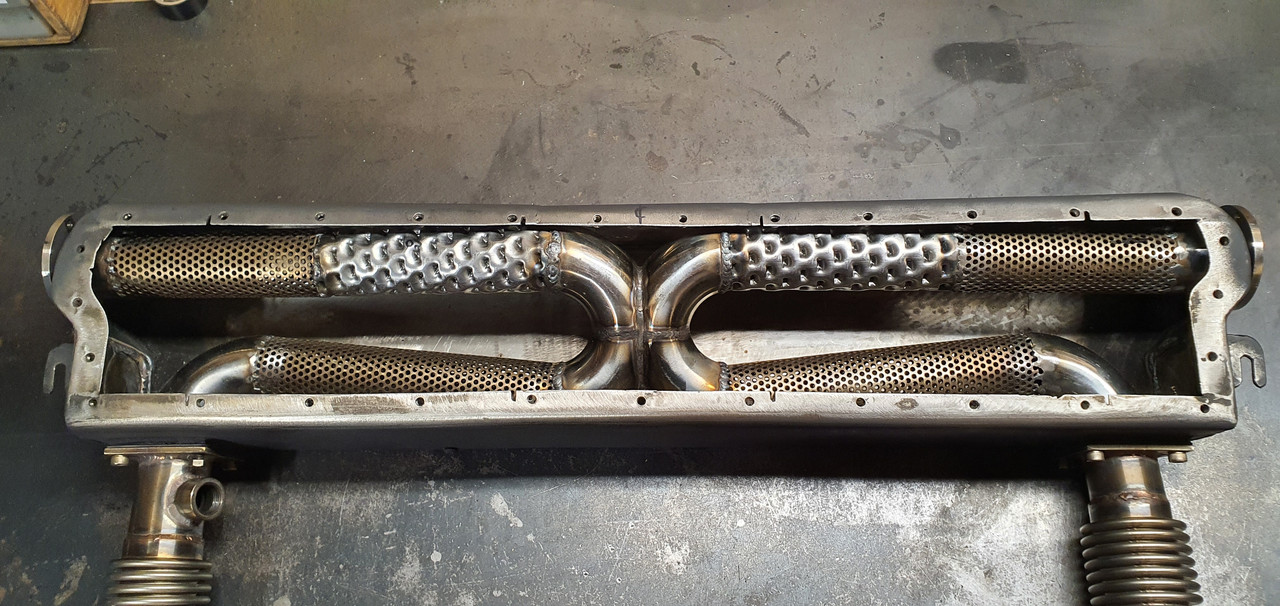

So this X pipe was connected up to some leftover spiral punch silencer tube and some of the perforated tube I made, pinched from box 1.3. Its a very simple layout ..

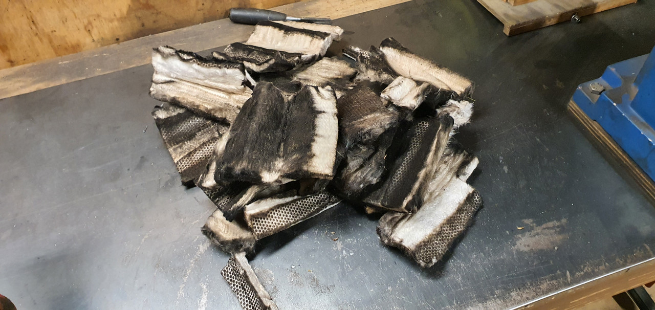

The glass fibre silencer packing pulled from box 1.3 was still in excellent condition...
A game of 'Itchy Jigsaw' was played with the pieces until the box was full.
Sealed and bolted down the lid..
I deliberated for a fairly short amount of time on what form the tail pipes would take. Ended up with an elbow on each end and gave the pipe surfaces an 'easy care' wire brushed finish.
Before the big exciting start up this morning a nice coffee was had. Then we took some vids..
Much better!!! In fact I'm really happy with this one. Its got a lovely flat six burble at idle, which could be improved if I lower the idle rpm - currently sits at about 800-825. Its smooth and quite subtle. Could be louder with a bit less packing crammed in.
At cruise its nice and burbly, although again, it could be louder, although I've only heard it from inside at cruise. There is absolutely no droning at any point
Once its opened up its lovely. Has a nice wail. Its so fun to drive fast with the revs up. Very smooth.
Only issue is the fumes. Exhaust gases from rear facing exits are still getting sucked into the low pressure zone behind the car and drawn into the cabin when our windows are down. So my next modification (Version 3.1) will be new exits angled off at 45 degrees - sort of like this..
I still love the look of the twin centre exit exhaust on version 1.3 but I think the exits separated like it is now helps accentuate the flat six sound. The actual box design and general look could be improved further, possibly with a neat perforated heat shield ?
But yeah. Very happy with this setup. It might be a keeper.

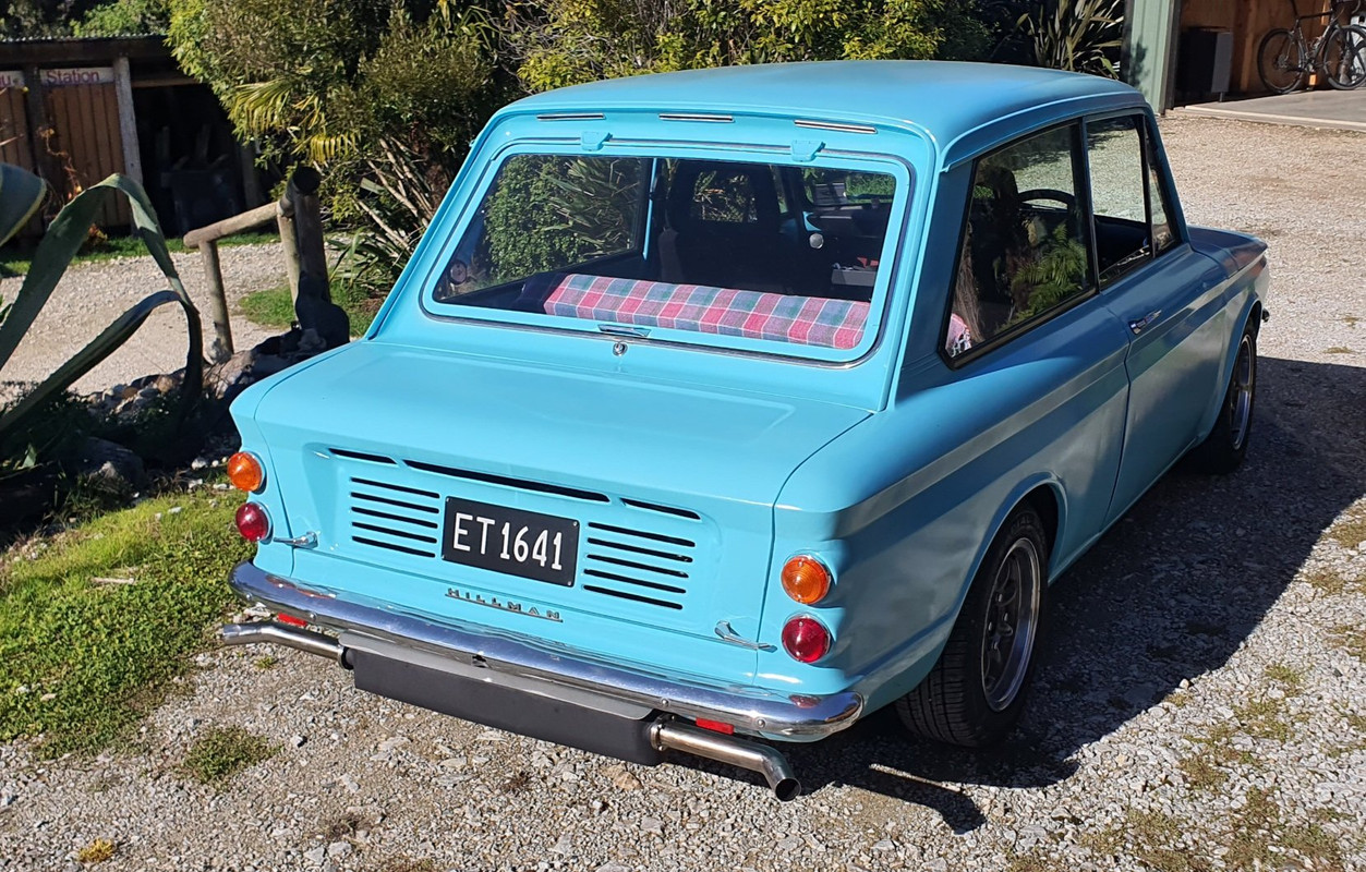

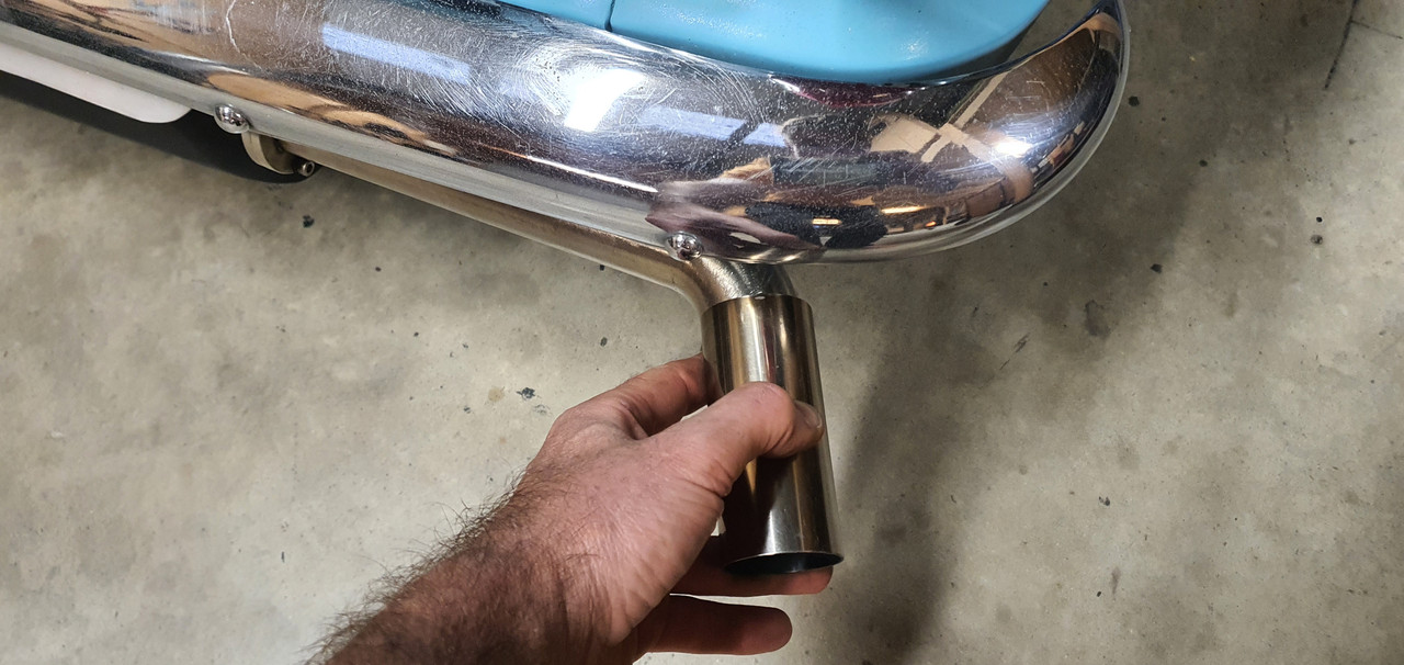

First off though is a pic of exhaust version 3.0 with added 0.1 extensions...
Pointing out at roughly 45 degrees and extended further these have so far seemed to have really improved the fumage issue. I'll have to do more driving with the window down to confirm. I still want to spend some time doing more tuning as well, smooth out the map and get rid of the really rich spikes sometimes seen.

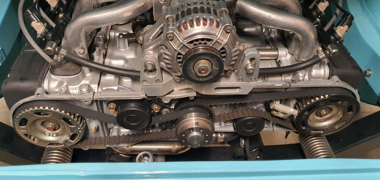

Well for roughly the last couple of months I have noticed that after startup whilst in warming up and the idle is high there's a funny whirring sound coming from somewhere in the engine. It was hard to tell where when the car was sat on the ground. I'd look underneath and try my best to pinpoint it but it's tricky with all of the general mechanical sounds bouncing off the ground. I was thinking the only thing it might be was the chain drives for the oil pump having bedded creating a bit of slack on the free side and somehow whirring.

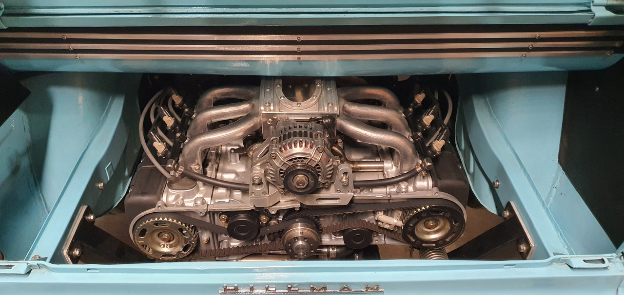

But this whirring sound? It goes away somewhat when the idle drops as the engine warms up and I cant hear over the exhaust from then on. So this morning I started the car up, moved it from its garage and out into the sunshine. I let it warm up. Then moved it inside and onto the hoist. Once up in the air I started the car (using my go go gadget arms) and listened from underneath. Being fairly warm the sound was barely audible until I reached up with my arm to the throttle body and gave the engine a rev. Bingo- there it is! Its in the cambelt cover! Its a flappy whirr. A rubbing flappy whirr.

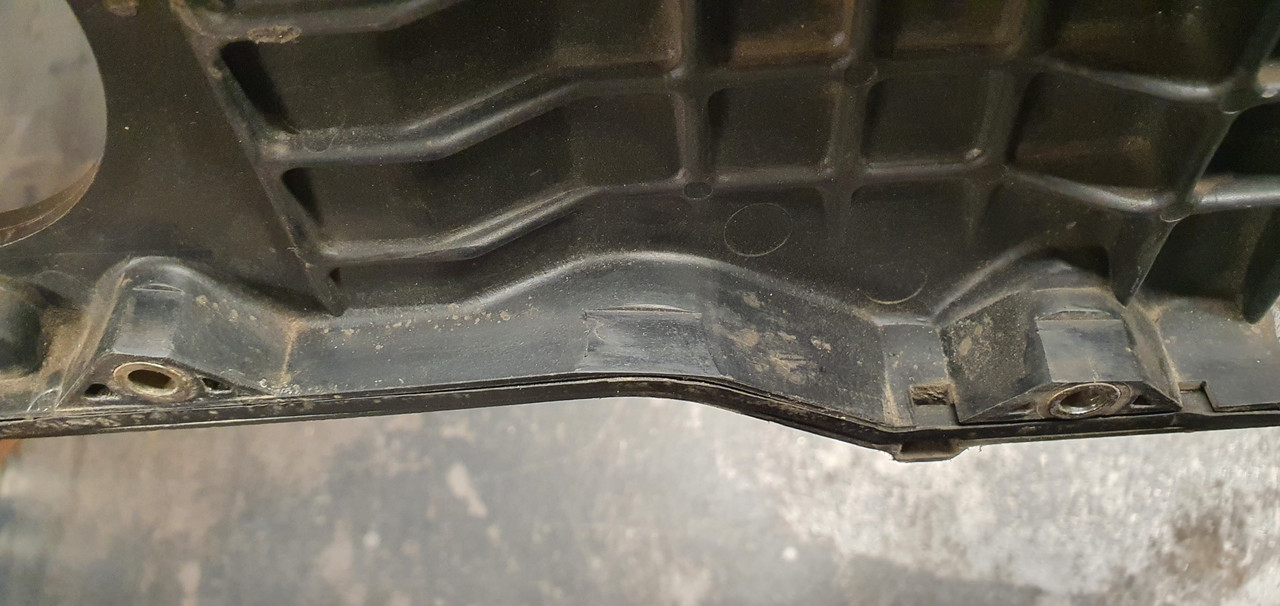

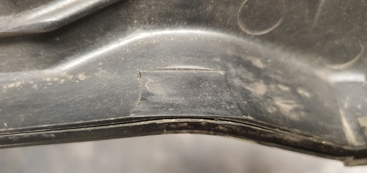

I let the engine cool down, went for a pushbike ride and then this evening it was off with the cover, which luckily is super easy to remove once the alternator pulley is removed from the crank.
Zoom in..
That bottom belt run on the left was a bit loose. Not terribly but certainly a bit more than the specified 5-7mm Honda advise. When the engine is cold its free to move that amount. I presume as it warms up it gets a touch tighter (boxxer engines 'grow' a little in width as they warm) The manual states that if the belts are too loose they can flap against the cover. Too tight and they whine. I could see where its been rubbing on the cover..
I have now tightened both belts just a smidge. Its a bit tricky to exactly measure 5-7mm but they seem about right. Cover back on and I'll test it tomorrow. (I'm not keen on filling the workshop up with warm up fumes tonight when our bedroom door is about in line with the roof of the Imp)
Interested to know if this is an issue many Goldwing owners have had?

Presume you know this but...
Honda on the 4 cylinder models specifies the belt tension as so much pressure in force, at a point in distance from the pulleys will yield 'x' amount of distance deflection.
Not familiar with the six cylinder version but surely they have kept a similar measuring spec.?
As you stated the boxers tend to grow or shrink slightly with temperature, so if it was warmer when you set the tension it might have gotten a little looser with the colder temperature.
Best of luck...
