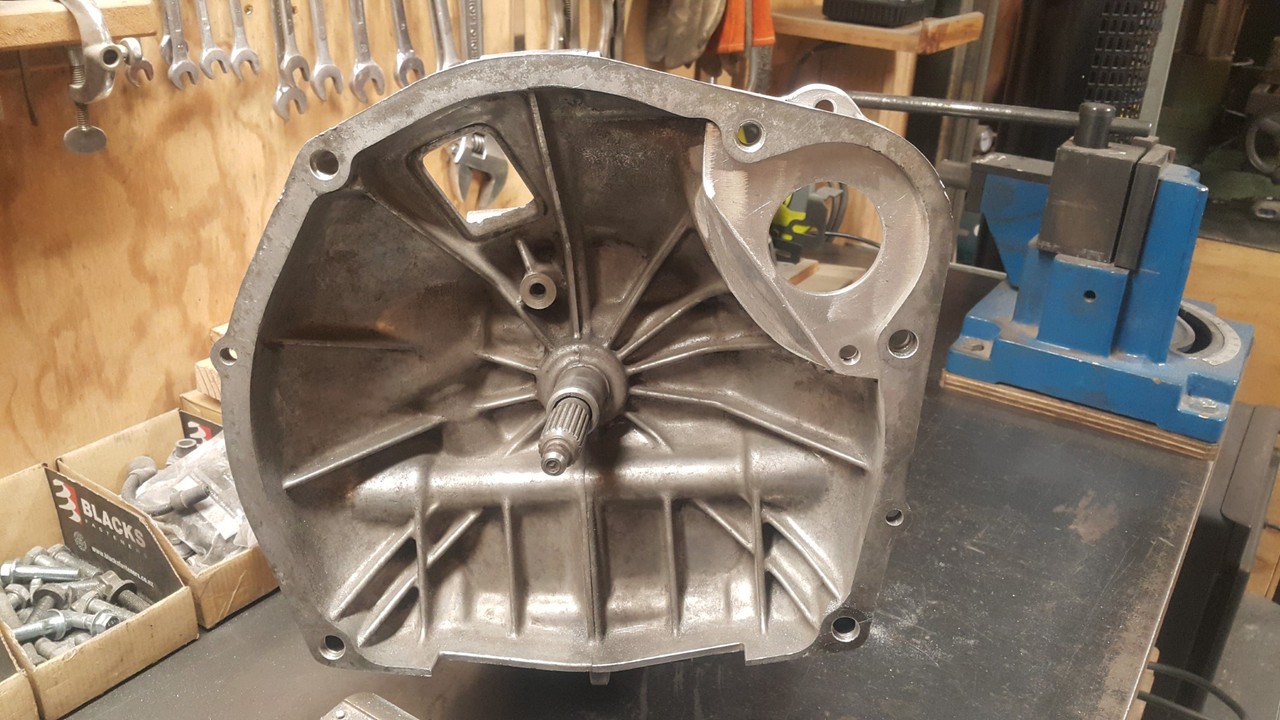

Back home I looked at my booty. Subaru one is on the left...
They were so close but not close enough. The Honda item has a smaller diameter 'locating spigot' that centralises it in the hole on the mounting face of the bell housing.
This was a better turnout than it being bigger than the hole though! I would machine the hole in the plate to suit the new starter, which I was going to have to do for the original plan using the Subaru one anyway.

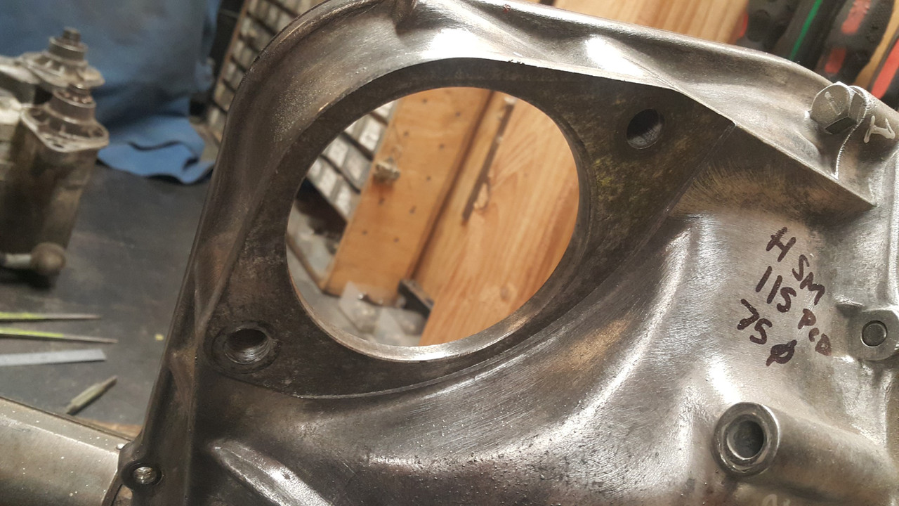

The holes for the starter mounting bolts, that go through the bell housing into the engine, were 5mm closer at about 115mm and they were also offset to one side, not in line with the starters centreline.
This was handy though because I could then have separate bolts holding the bell housing and room to turn the Honda starter about its axis, having the solenoid positioned in the least obstructive way. A plan was forming in my head. I took some measurements, did some scribbles and it all looked like it should work ok...

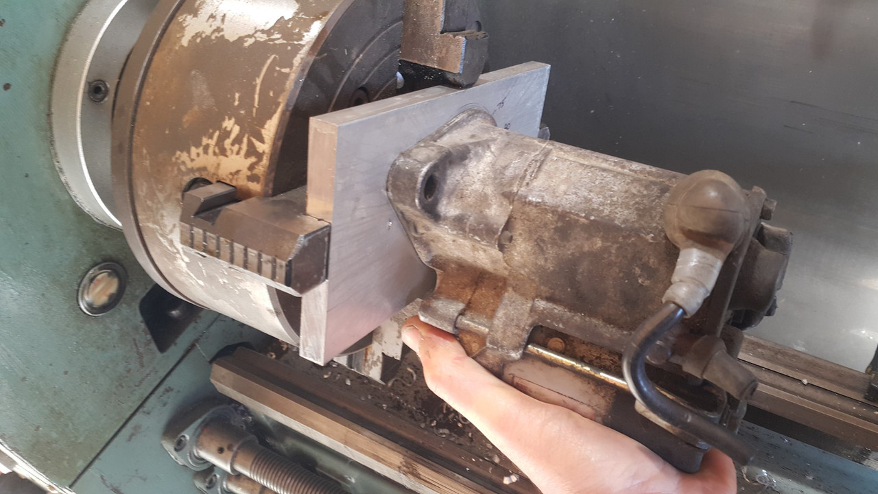

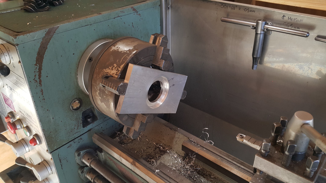

I had already bought a hefty bit of 12mm plate for the Subaru starter repositioning and luckily it was still going to work with the new starter. I swapped the 4 jaw chuck onto the lathe and set it up. Drilled a big hole...

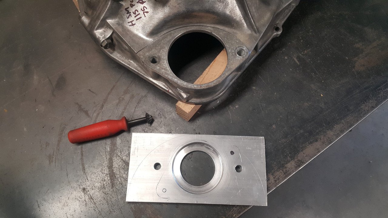

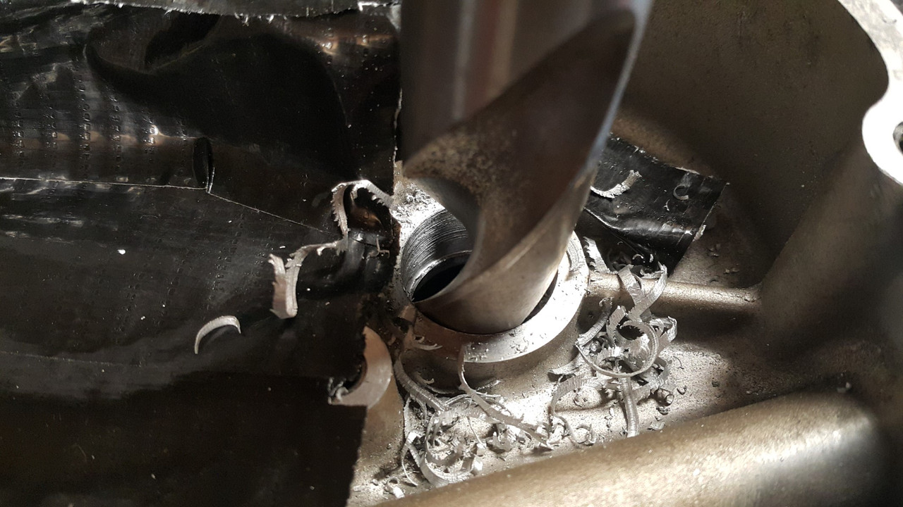

Bored the hole out to suit the Honda starter spigot...
Marked and drilled holes to suit...
Recessed and spot faced one of the holes for the bellhousing to the engine bolts that just happened to slightly clash with a bit of the starter casting.

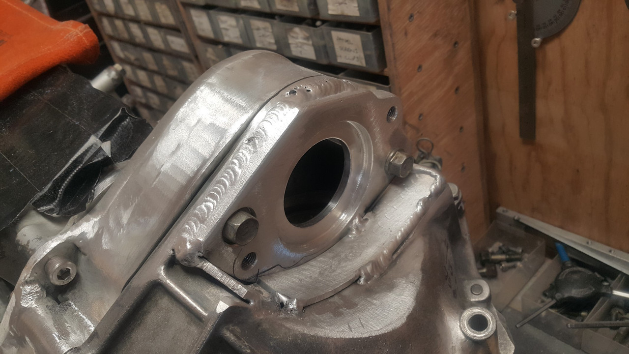

So I now had a plate that the starter fitted neatly into, with not a hint of slop. The bolt holes lined up perfectly with the bellhousing bolt holes so lining the starter up the correct distance out from the ring gear. Now I need to move the face of this plate closer to the engine...

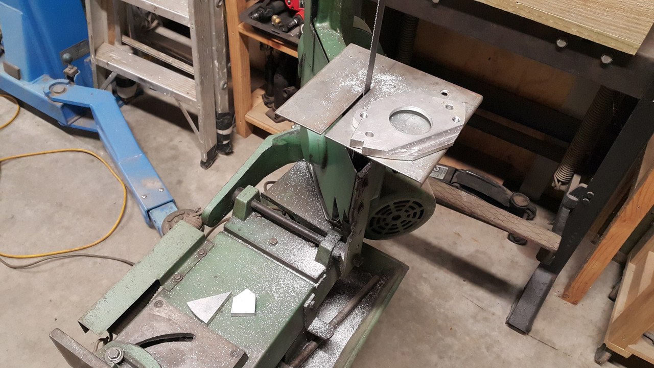

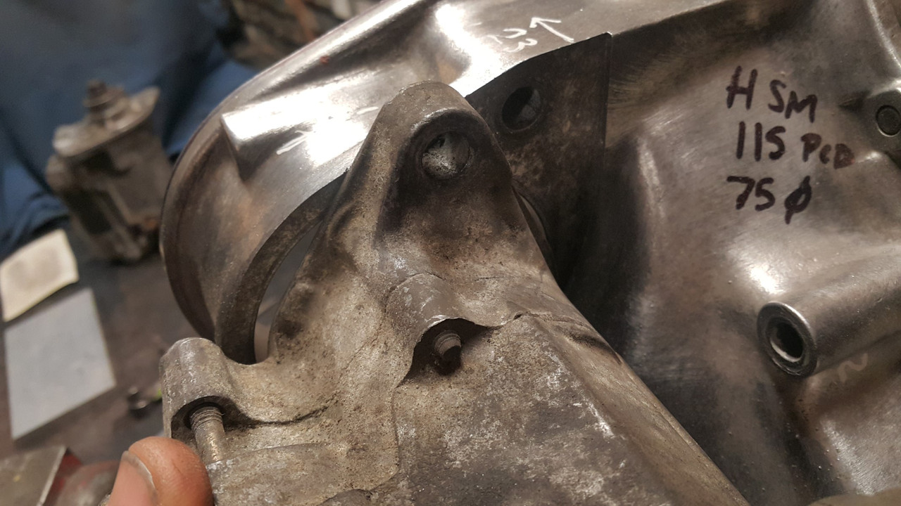

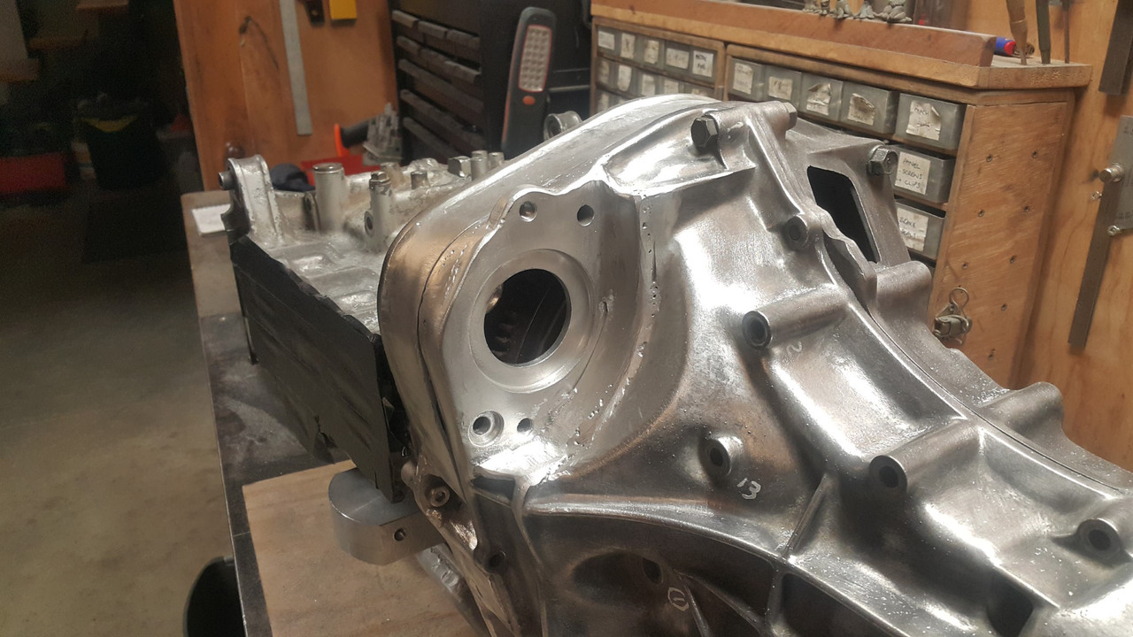

So I cut a big lump of alloy from the bellhousing with a grinder and a hacksaw...
This allowed me to move the plate closer and let the pinion fully engage with the ring gear...
I tested the fit of the starter...
The height was good but I wanted it to be perfectly parallel to the face of the flywheel so I really had to mill it. Luckily I was just able to squeeze the gearbox into a position on the mill that allowed me to face it perfectly...
I must have some pretty honed hacksaw skills because I only needed to skim off about .75mm to get it flat. Sweet.

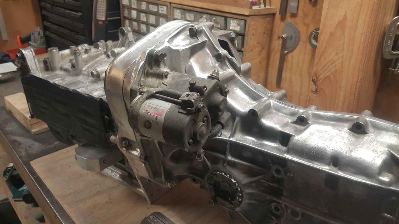

Now I bolted the plate in place, then the starter and tested it...

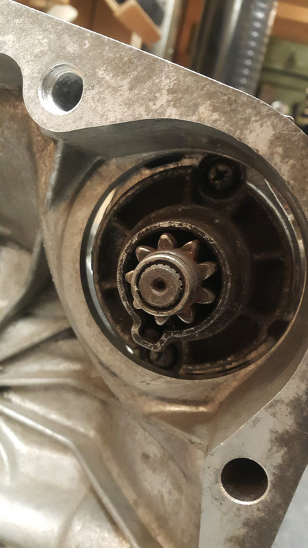

Oh I forgot to mention that once I had decided I was going to use a starter mounted in the original position I popped a hole through the adaptor plate in line with the starter pinion. This was to allow me to check the pinion mesh...
I was super happy with the mesh so I marked the excess on the plate to be trimmed off and gave it a hair cut in the bandsaw...
I also milled out the back of the plate where it just clashed with the rivets and pressings on the outer edge clutch pressure plate. Bolted it back in and welded it up, taking lots of care to avoid any chance of movement or warping. It went well..
Added some little filler plates to tie it in neatly and gave it a tickle with a flap disc...
Bolted the starter back in, stood back and admired it all, really happy that one of the trickier jobs had been completed and that the starter was sitting in there very neatly and tucked away nicely, no higher than the top of the bellhousing...

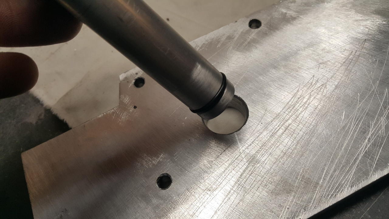

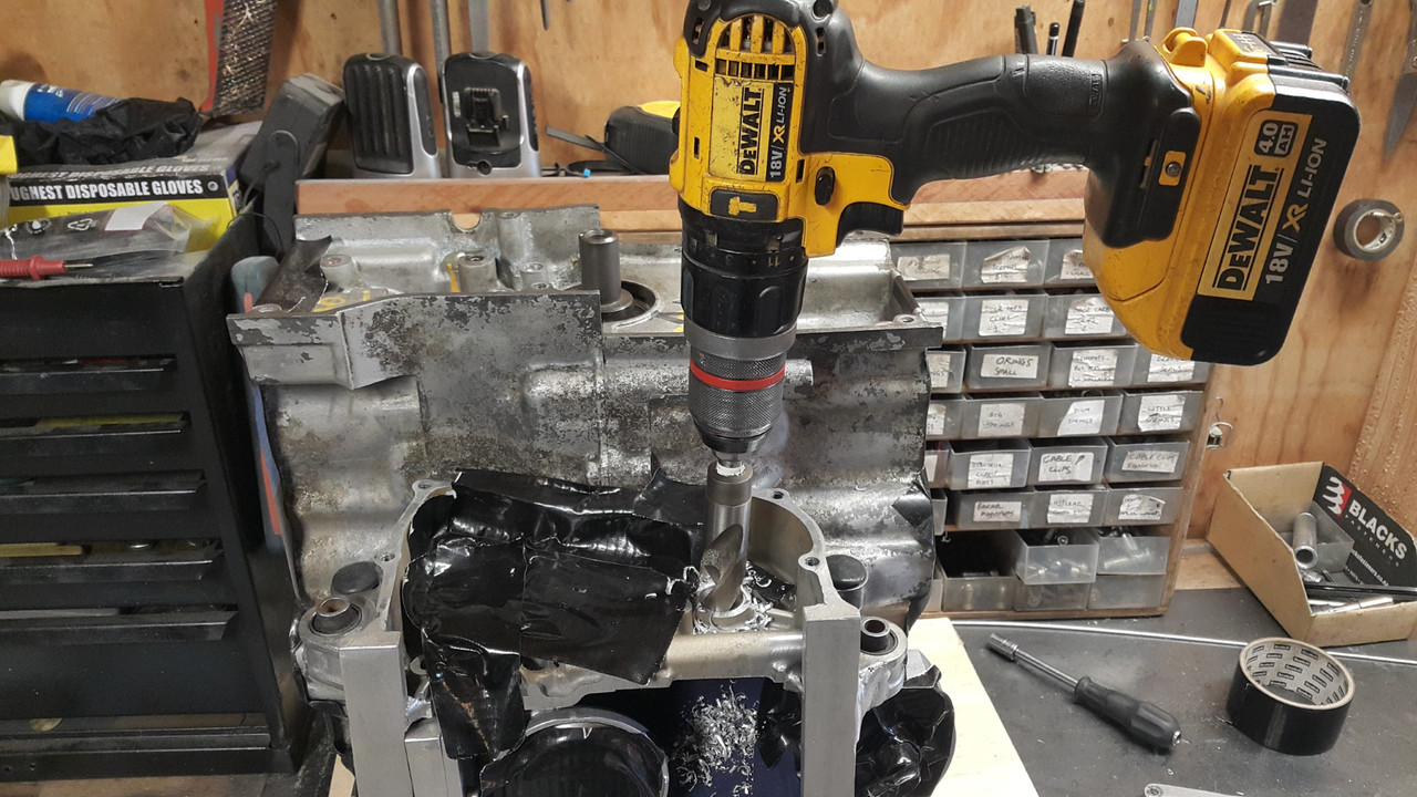

I started with some more chunks of alloy and made a thousands of teeny tiny chunks of alloy with the tablesaw...
One of the blocks was then milled out to suit the pipe outlet and oilway inlet sizes. I also used a tiny little slot drill to add a groove to help keep the sealant in place..
Flipped it over and took more material away. Added some cooling grooves. But really.. come on. They were more just so it looked a bit nicer than just being a lump of alloy. Why not..

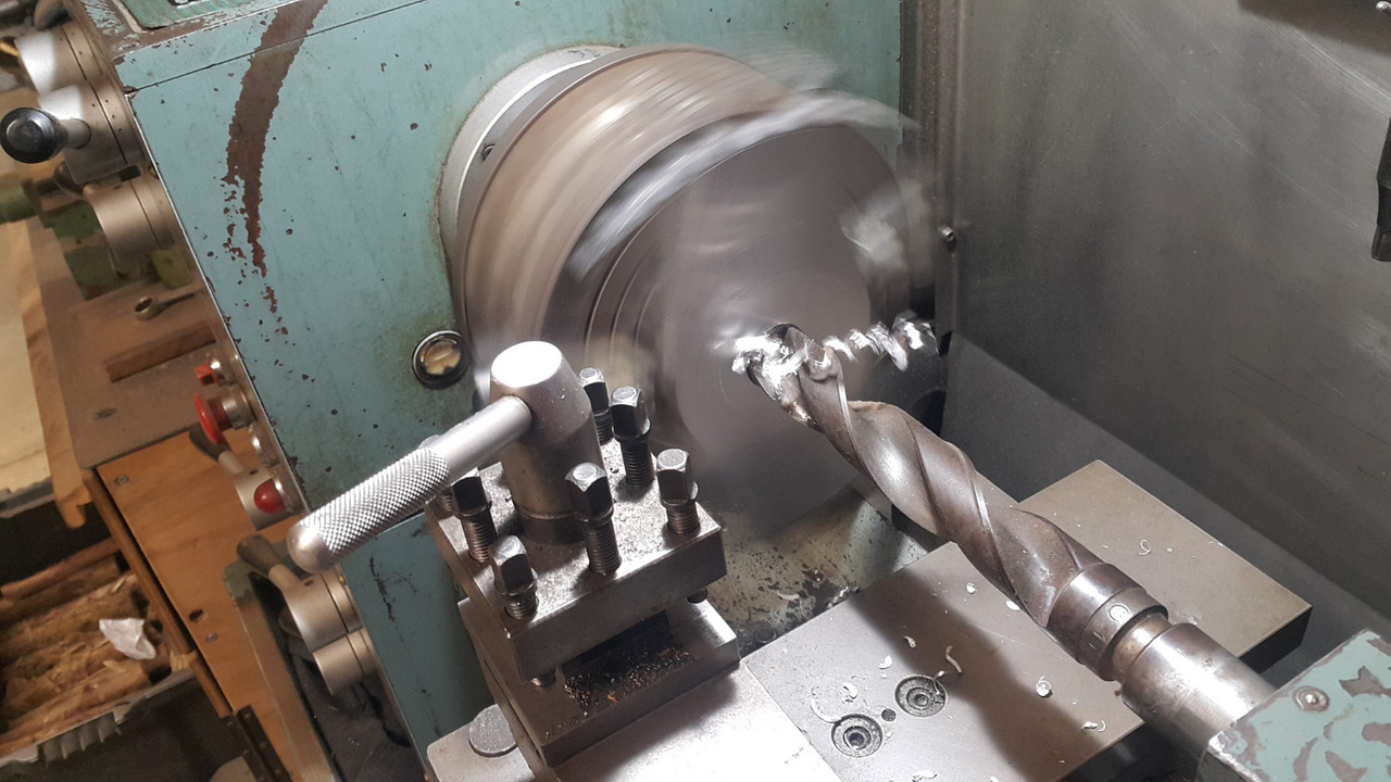

I rummaged through my collection of alloy..
Playtime in the lathe...
and out popped this...
..into which oil will pour as such....
